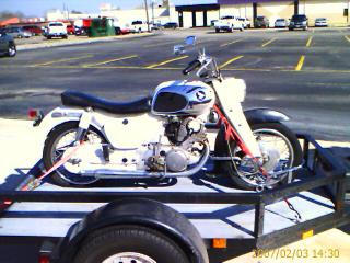

Well here is when I brought it home and tomorrow off to powder coat.
Oh, you can't powder coat Bondo..... Anyone have a front fender they want to sell? The bottom of mine where the mud flap attaches is smashed.
