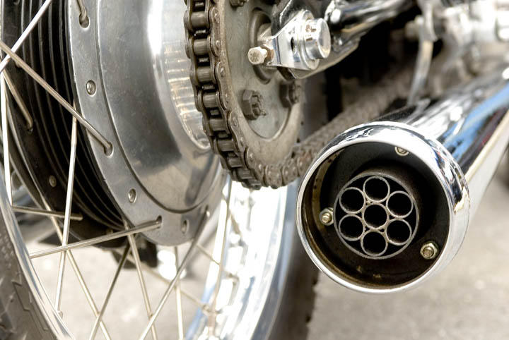

Baffles - I'd bought a set of repro baffles on Ebay from Apex and they look like good reproductions
of the originals; however, they won't go into these silencers. The silencers are not internally the
same as the originals but are of the absorbtion type and the "tube" containing the exhaust packing
has a smaller ID than the baffle OD and comes much closer to the end of the silencer.
I've read a comment from LM on another thread about there being different baffles for the CLs, so
maybe those would fit but these are definitely CB silencers.
