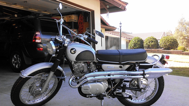

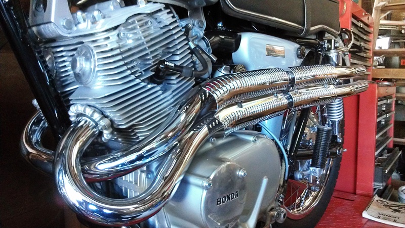

Nice job Sara!!!
All that time, all that worry, and all that frustration makes for a memory that you will re-live over and over and over for the rest of your life. I know that it is a great feeling of accomplishment and satisfaction when a project like yours comes to an end. Actually the project is now in it's beginning stages of life as you go forward with making it reliable and fun to ride. You will probably at times not want to take things apart again, but will have to, so that she can be at her best performance level.
Congratulations on a job well done. It really looks nice.
Rickytic and his CL77

Ricky, thank you!!!! It IS a feeling of accomplishment, and it's way more than just satisfying. It seems these old bikes have a strong connection t each of us who take the time to bring them back. That just cements that connection!
Your CL is just spectacular. I'd be afraid to take it outside! You have every reason to be very proud of her.
