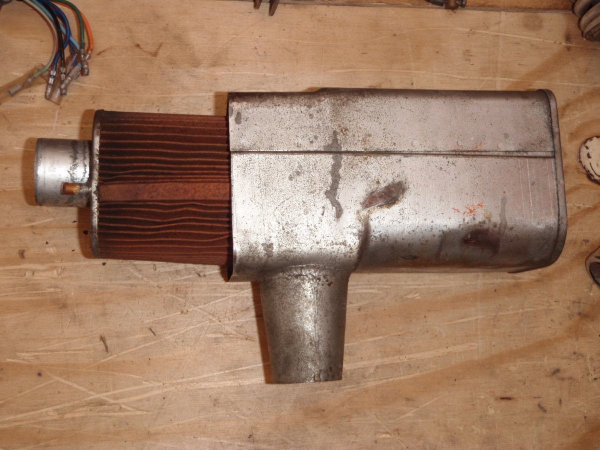

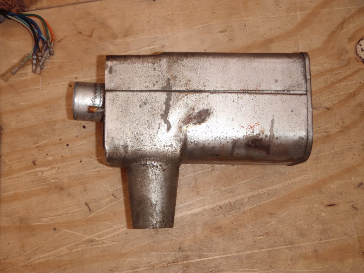

Post by jensey » Thu Nov 19, 2015 1:09 pm
Talking about air filters, guess what was on my early bike ?
