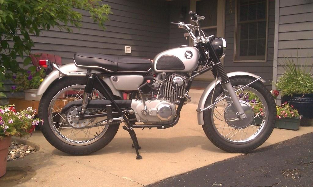

Hi again! Thanks for the compliment on the bike. Seems like it will never come to an end---I have some glitches that I can't get figured out unfortunately. I have the lights all working except the neutral light--not sure what the issue is but that is of little importance right now as I have a spark issue on the right side---good spark on the left but not on the right. It is sparking at the points when it opens and closes---and this is new points I just got. I need to do some research, maybe a condenser? Or coils? I am not sure. Talked to Ed one night and he tried to walk me thru it but I never did get it fixed.

Ok, ordered a used coil from ebay and that was the culprit. Hooked it up and crossed my fingers and lo and behold, there was spark to both sides. Well another snafu taken care of. Now to move on and get this baby fired up.

Well, almost done. Having troubles with the engine right now. I have spark on both sides and have gas to the cylinders but only have backfires at this point---doesn't even sound like it wants to run. Need to look it over more.
And yes, it is missing a few parts at this point. Don't want to put bottom footrests on until I clear this stuff up.
