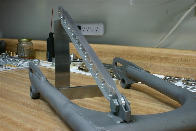

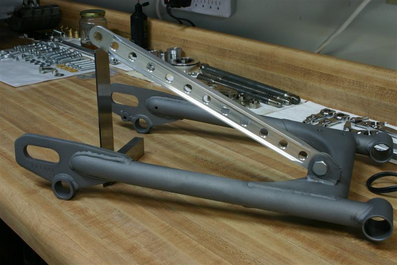

Been wanting to make a torque arm for the brakes, made this Saturday, mainly aesthetics, as it only weighs 1.8 oz less than stock; front will be less involved.. Made from some scrap 6061 alum on hand.
engine build 002 (Medium).jpg (48.61 KiB) Viewed 5791 times
engine build 001 (Medium).jpg (61.13 KiB) Viewed 5791 times

Beautiful!
Dick Eastman wrote:Been wanting to make a torque arm for the brakes, made this Saturday, mainly aesthetics, as it only weighs 1.8 oz less than stock; front will be less involved.. Made from some scrap 6061 alum on hand.

Well done, as usual. I don't know if you will be using a (relatively) stock centerstand, but if you are, make sure the tab that the return spring attaches to does not interfere with the brake torque arm. Regards, Chase

cknight wrote:Well done, as usual. I don't know if you will be using a (relatively) stock centerstand, but if you are, make sure the tab that the return spring attaches to does not interfere with the brake torque arm. Regards, Chase
Thanks.
Yes I found a nos center stand I am using - thanks for the caution.

Guess I should have added the words "when retracted" at the end of the sentence. The clearance is certainly affected by what you use for an exhaust system aft of the header pipes. You may want to weld on some doublers (1/8" steel material, properly bent) to reinforce the bottom of the kickstand pads where they contact the ground. Lots longer life than provided by the stock material, and the additional height that's provided will help rear tire-to-ground clearance with whatever rear shock length and tire sizes you go with. I'll probably use the MotionPro 5mm vacuum fittings, just a tad larger tap diameter than your 10-32. Thanks, Chase
