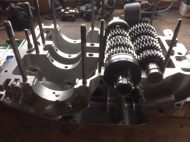

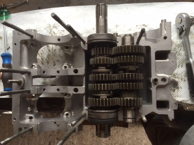

Hello Dave
Just getting a chance to look over the pictures of your bike. Its good to see more "new" old race stuff.
A few observations / guesses, from the pictures of the gearbox I would say its a Nova one but an early type, I think the actual gears are the same as the later ones but the selector drum and more importantly the mechanism was changed on the later ( current ? ) boxes to a system similar to the CB350K ( this also reverses the change pattern ) as far as I know the mod. was first done to prevent over-selection ? problems with the early Nova change drums which were heavier, possibly solid items, compared to std. and original Honda 5 speed drums.
I would think that the setup on yours is to help stop the over-selection problem but like others have no idea from the pictures how it works !
You don't see many CB72/77's racing in the UK now but at one time the CRMC ran a up to 63 class which they could run in and before they re allowed the K's in they were about the only Honda you could use in the Classic Manx.
I hope this all makes sense and hopefully some of the others on the site may have more info for you.
Gordon

GORDON BROWN wrote:Hello Dave
Gordon
SAFOJ
Hi Gordon
Thanks for the comments and guidance.
I can't thank everyone enough for all the kind help and guidance on this forum...It is a joy to be a part of it. Thank you all. :o)
Dave

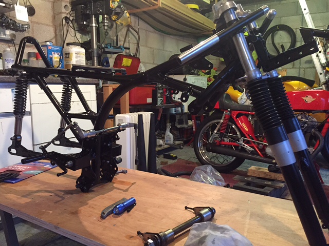

Started re-building the frame

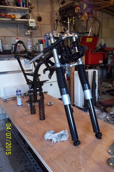

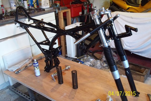

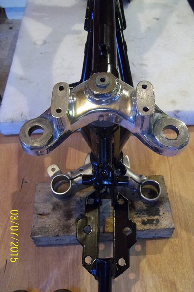

Post by lloydy1 » Sat Jul 04, 2015 2:48 pm
Thought I would make a start on re-building the frame while I wait for the casings to come back from the aqua-blasters.
Couple of pics so far.
Dave
Re: Started re-building the frame
Post by G-Man » Wed Jul 08, 2015 4:25 am
Dave
Some good progress happening there. I look forward to seeing the bike up and running. I've not had much time for bike projects lately so I am a little envious.... :-)
Any more info on the history of your bike?
lloydy1 wrote:Thought I would make a start on re-building the frame while I wait for the casings to come back from the aqua-blasters.
Dave
Post by lloydy1 » Wed Jul 08, 2015 5:47 am
G-Man wrote:Dave
Any more info on the history of you bike?
Hi G
Drawn a blank at the moment on its past life I'm afraid, which is a shame. (If only it could talk)
I have the swinging arm and shocks back on her now also. Just waiting on the casings coming back to start the engine rebuild.
Visited Alan a week or so ago. He kindly shown me around his beautiful collection and gave me a few pointers.
I will keep you posted with updated pics as I progress.
All the best Dave
Dave

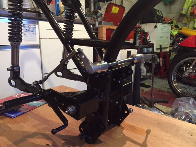

Post by lloydy1 » Fri Jul 10, 2015 4:07 pm
Swinging arm in place. The gear change conversion was a little bit of a puzzle. When I refitted it it was very stiff to move. Bit of head scratching and after installing it and taking it off a few times found that it was tight on the frame. I had to remove a bit of meat from the cross bar. It must have been like that before as I hadn't altered the fittings in anyway.

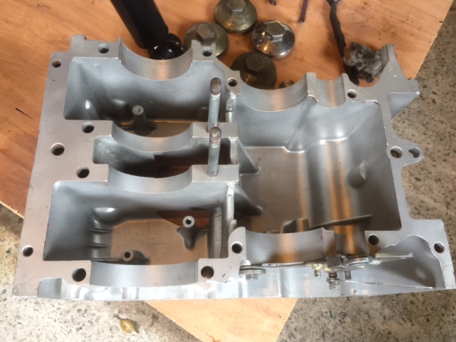

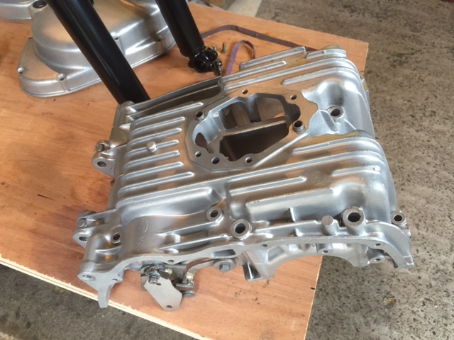

Post by lloydy1 » Sat Aug 01, 2015 11:46 am

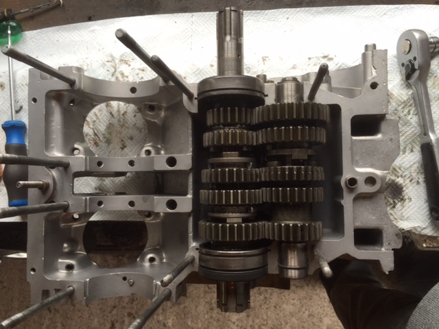

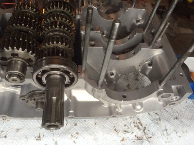

Had the casings back from the aqua blaster.
Bottom case all cleaned
