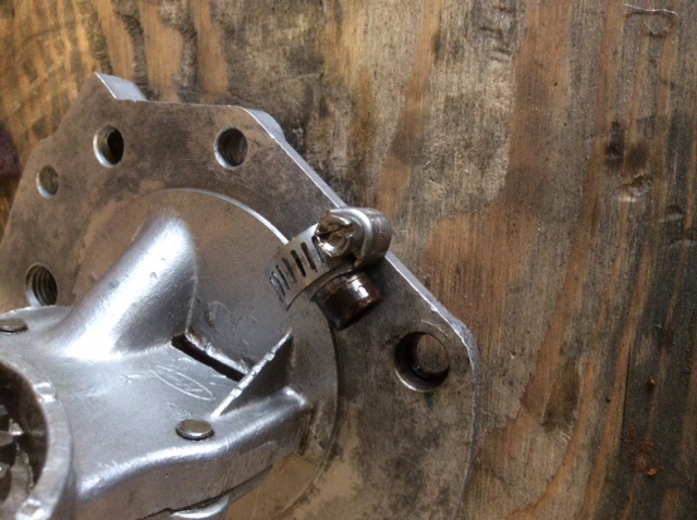

Post by Seadog » Thu May 07, 2015 2:49 pm
You guys are the best, not only do you provide valuable information and insight, but you make me laugh too. Thanks.
I got the darned thing out of the oil pump base but I haven't tried the one in the lower case yet. I put a bit of PBBlaster at the base of the pin, tapped it lightly for a bit, then put a hose clamp on it. I then tapped the clamp knuckle with a brass rod and a small hammer. Out it came. Who said that necessity was the mother of invention?

Thanks, LM. That's the best answer yet - don't remove them at all. I'll leave the one in the engine case alone.
When I cleaned up the pump housing and the filter, it appeared that the gaskets had been glued down with what I guess to be a shellac gasket compound. I think that's what was holding the pin in too. Once I cleaned the pin and the hole, the pin slides in and out freely. Was shellac gasket compound the right thing to use on the gaskets and on the pin?
