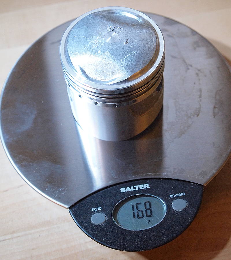

What size are your current pistons. You can carefully clean the piston crowns to read the markings and measure the bores at the bottom where they wear less. The piston in my picture is 0.75mm oversize so the matching bore would be around 60.75mm.
Incidentally, the part you called the cylinder head is the cylinder barrel, jug, block or whatever. The part with the valves in is the cylinder head. It helps to use the right terms when talking to machine shops etc...

Not seeing any marking on the crown of the piston...did Honda use a standard size in these engines and therefore not label the sizing?

When HONDA assembled the engines all pistons were STD. size therefor no size was stamped on the dome. ...................lm
