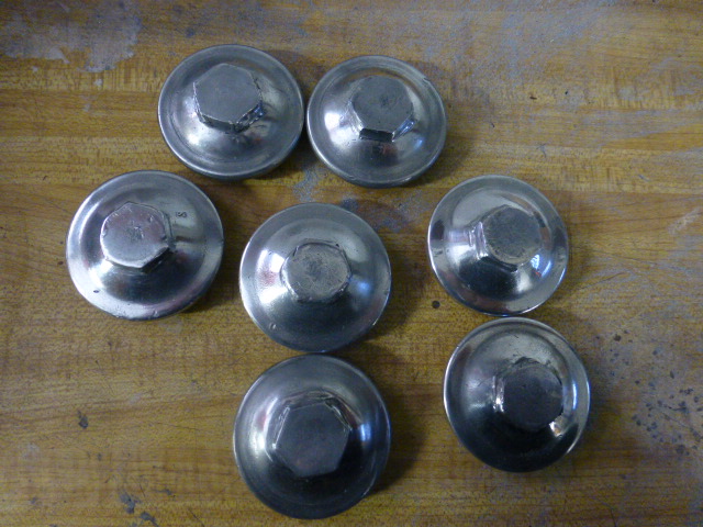

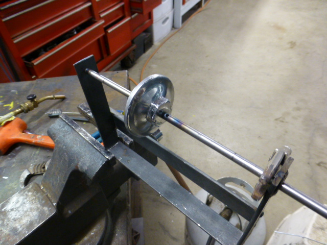

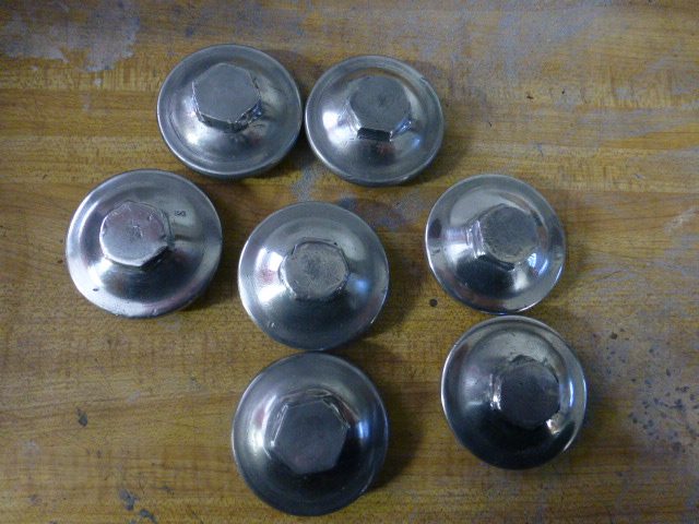

Made a fixture to hold the valve caps while attempting to repair them. They didn't come out perfect, but much better than they were. Some had been removed with vise grips and were pretty chewed up. I did ruin one, had a brain fart and tried a method that I should have known wouldn't work. It was the first, and worst, one, so I'm not too upset. I was a little concerned that they might warp due to the amount of heat used (about 730 degrees) but they didn't. Using a die grinder with a sanding disc worked pretty well, but it would have been nice to have a mill, they would have come out much better. The hex wrench actually fits tighter now than on my unmolested covers that are on the bike.
