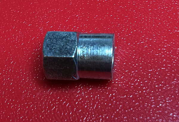

You are correct, LM; the nut in question is the one that came with the bike at that location. I did order and install a new special crush washer (aluminum, similar to the oil drain seal). But even though I saw the different image of the nut in the drawing, I thought it may just be one of those "it doesn't look like that in real life" situations. I suppose I'll have to look for a special nut. Is blind nut another term for cap nut? I'll be looking for another "WASHER A, 6.5MM 90481-250-000" and a "NUT, SEALING, 6MM 90241-259-000" to fix that. I suppose a drop of thread sealant on the tip of the stud wouldn't hurt either. What is the point of this arrangement anyway, from an engineering standpoint? Why have a hole in the bottom of the case that we have to plug with a washer and nut?

LOUD MOUSE wrote:I also noticed the missing blind nut but here in the states we had/have aluminum washers at that location.
Looks like he may have the aluminum washer installed but incorrect type nut. .....lm

Your little M6 bolt next to the oil pump should have a blind nut with a copper washer underneath. You'll find that in your meticulous pars system. Not sure about the other drips on the oil pump. You may have to wipe that down and watch the area as you run the motor again.

LM is correct, that M6 sealing washer is aluminium, not copper. I'm just not a big fan of aluminium washers.....
The nut just like a tall hexagon with a flat top - see picture below.

Okay, so searching the web for those parts is sad making. Someone on eBay is selling the wrong part as the special nut. The only place I can find the strainer is CMSNL, along with the nut, but with shipping the order is over $60. Gonna try the wanted thread before going overseas...
Hey, G-Man, you wanna sell me the nut that's in your photo??

I'll send you the nut and strainer for nothing but you'll have to wait until the weekend before I can mail them. I'm out and about the next couple of days...
