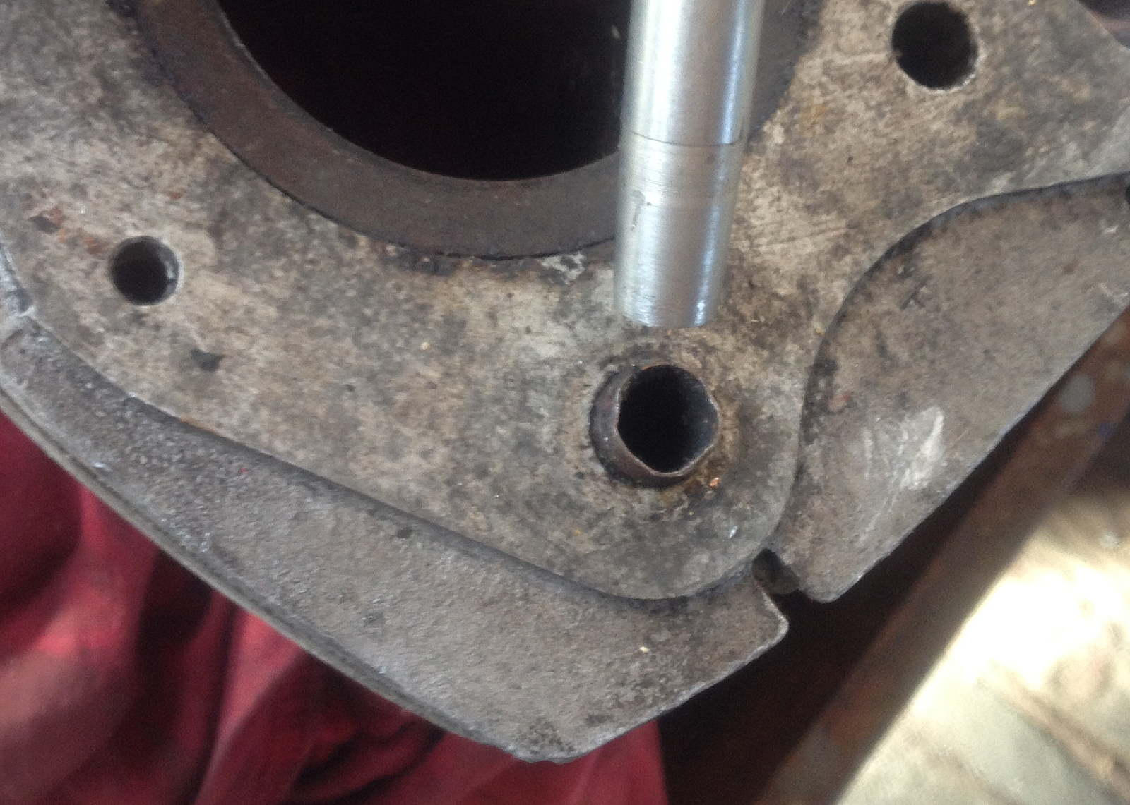

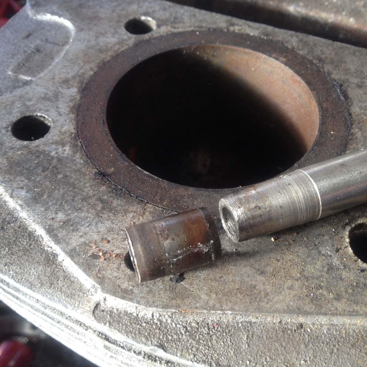

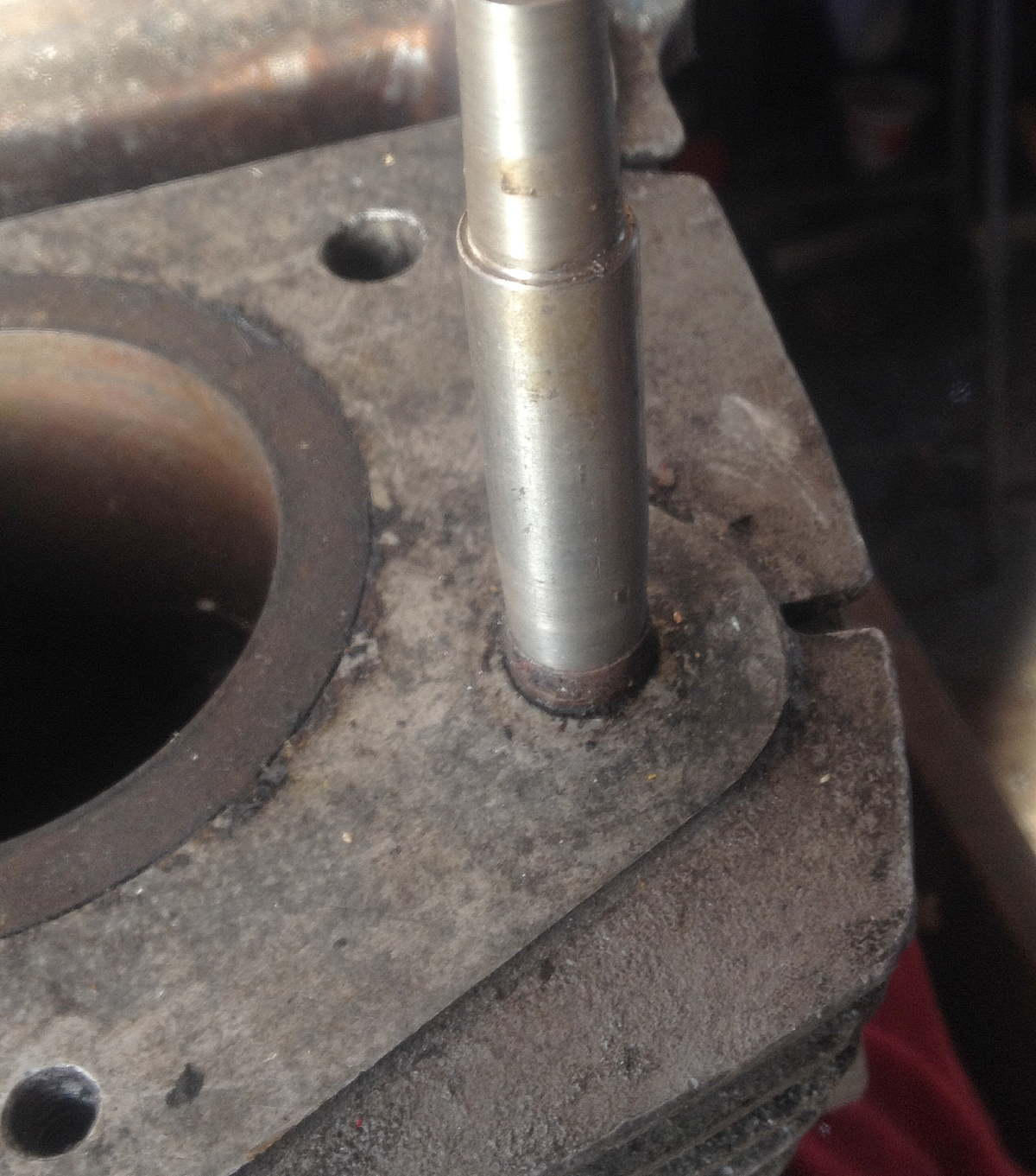

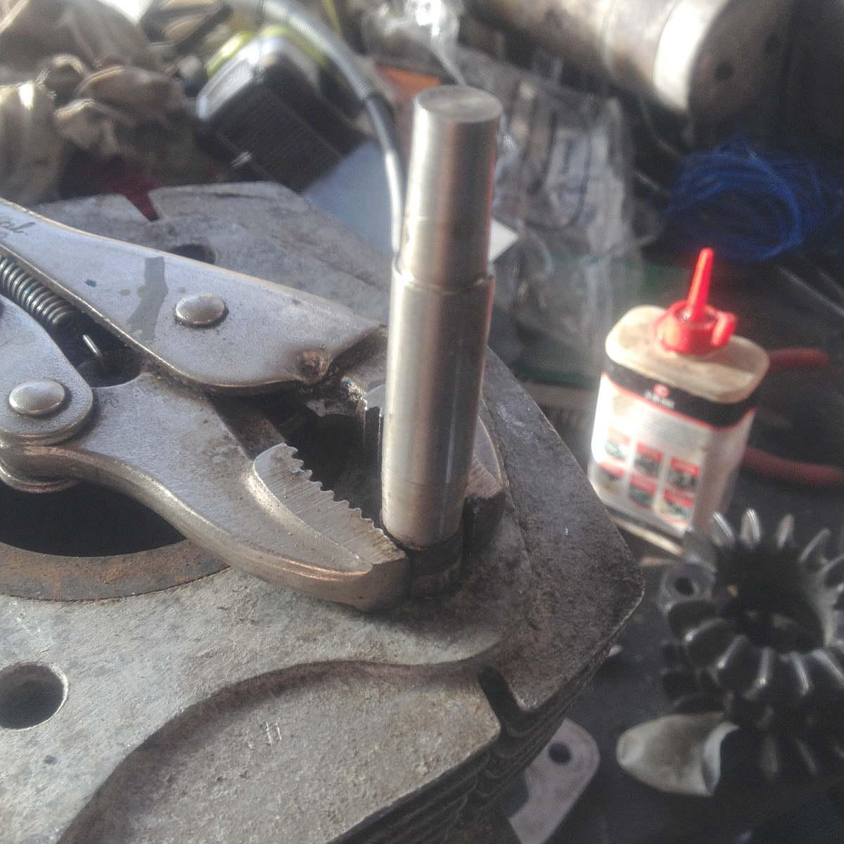

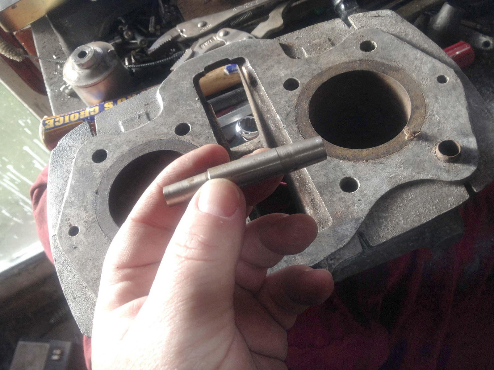

Just for reference - here is my little tool for getting out corroded and squashed knock pins (us old-country folk call them dowels).....
I just bought, as a job lot, 3 CB72 motors in pieces. Had to remove a number knock pins before bead blasting..

Graham, that's an elegant, simple tool! Brilliant.
