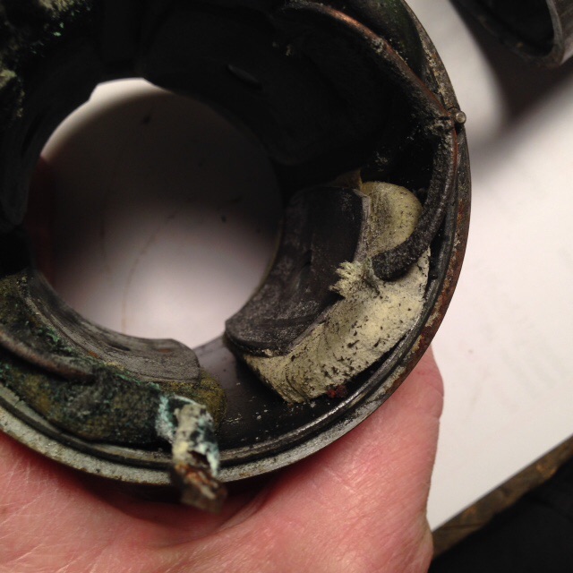

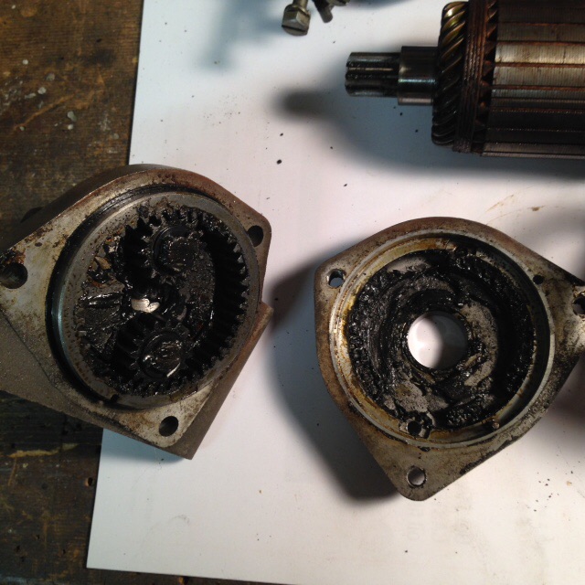

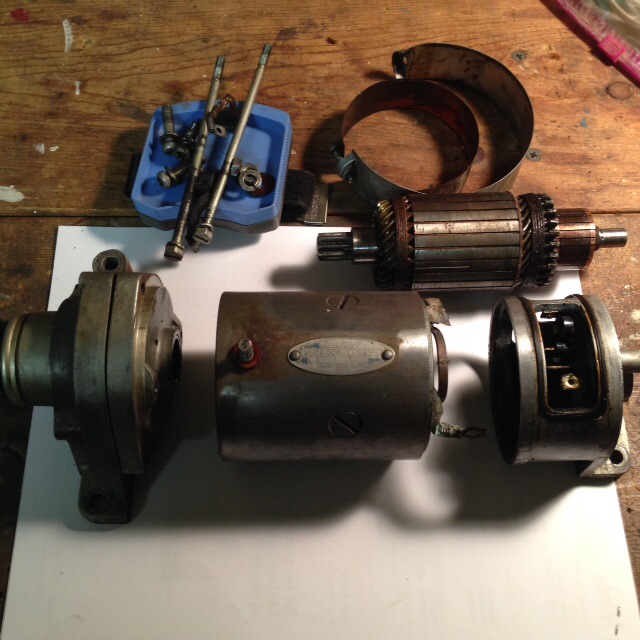

I easily found a great thread on rebuilding starters here, so i decided to take mine apart. I had no problems. The inside was greasy and mouldy. The gears were well greased and move smoothly, but the grease is black. All-in-all, not bad. A good cleaning, new brushes, fresh grease and some paint for the case should take care of it.
Posts: 1273
Location: Cape Cod, MA
Post by Seadog » Wed Apr 29, 2015 5:38 pm
Thanks to NBD925's excellent starter rebuilding thread, I finished with my starter today. It really wasn't as beat up as I had originally thought. The rust on the outside was the worst of it. I would have replaced the brushes, but I haven't been able to find replacements yet. I'd guess they're about half worn. I reinstalled them. They should still have a bit of life left. It's now masked off and ready for paint, which I'll get to in a day or two, when it's warmer and drier.

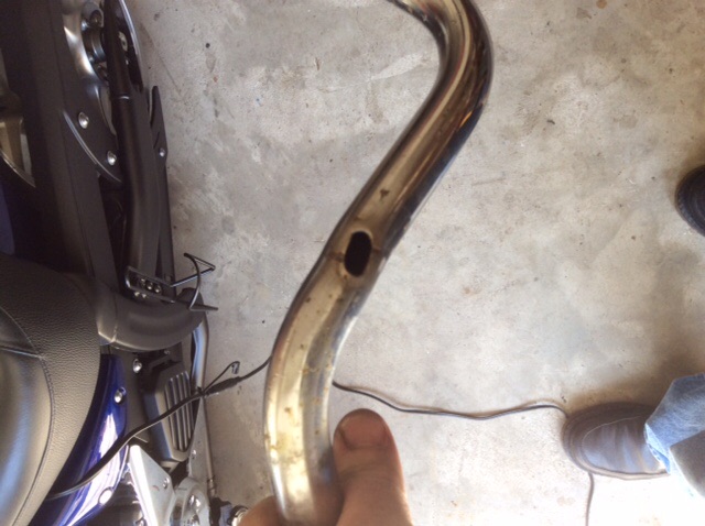

I finished painting the starter parts and will install them in a few days. I stripped the handlebar down, thinking that it could be re chromed, but found that it had been badly bent on the right side about an inch inward and the wiring cutout is distorted. The end of the bar is somewhat mushroomed from the impact too. I might try to heat it up and bend it back, but I don't think that I could ever trust it. I'll have to search for a replacement. I wonder if another Honda bar would be suitable - maybe from an early CB?

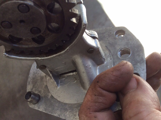

I started cleaning the old gasket material from the oil pump. I'll strip it down and clean it thoroughly too. One of the two knock pins is still in the lower case and one is in the pump flange. It won't budge with very gentle persuasion and I don't know whether to be concerned about that or not.
