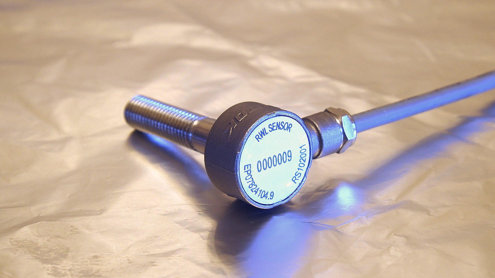

I sympathise with your night shift. I have to do two nights in the Park Avenue railway tunnel under Manhattan on Monday and Tuesday from 21:30 to 05-30. We are doing the preparation fro installing some of our rail sensors which measure strain, vibration and temperature to detect faulty train wheels.. It's cold dark and generally nasty down there......
