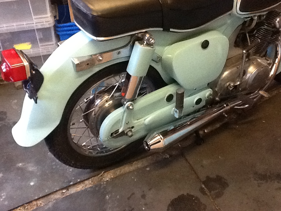

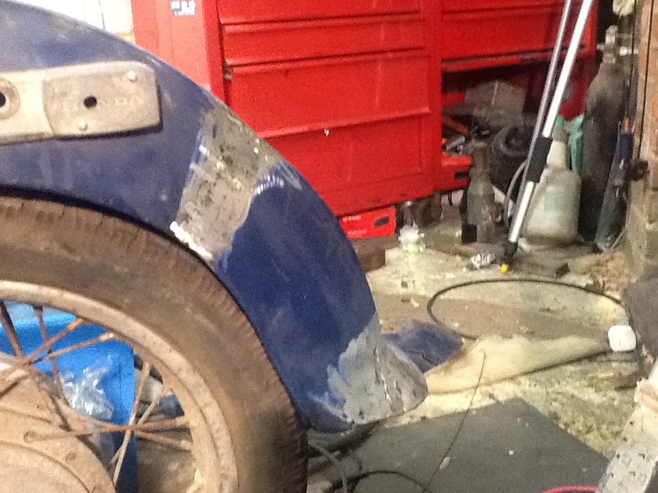

I had the same issue with my CA77, both mudguards had been cut down. I managed to get a damaged but complete front mudguard which I knocked back to shape and welded up the splits in it. I then used the original front guard to replace the large piece of damaged and cracked rear guard. The profile was not exactly the same but the difference is small and I added a skim of filler to blend in the difference which is behind the rear number plate.
A bit more work was needed to get the profile looking somewhere near right.
