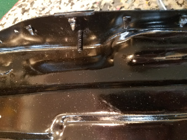

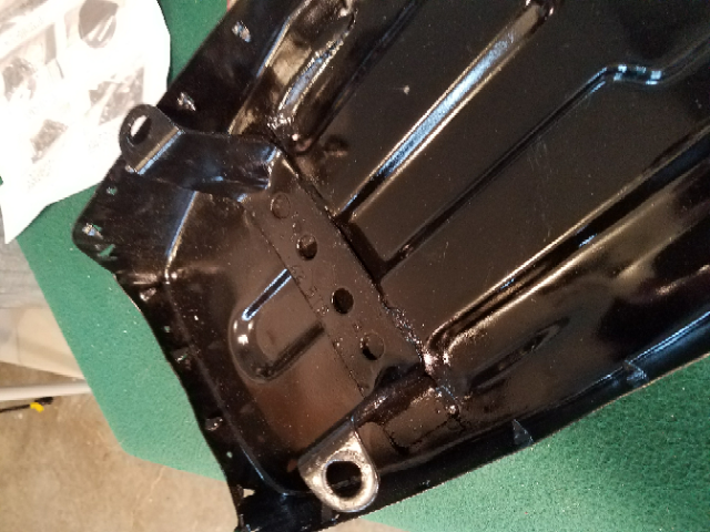

Glenn-N wrote:Is there a difference in CL72 and 77 seat pans?
Got this one laying around waiting for a fresh powercoat.
Still has the original spikes if I'm correct.
Now I only need a new foam, cover and the trim.
Here are some pics of the seat pan from my 67 CL77. My question is how do I mount the seat? My manual is from early model CL77s so it doesn't show how to mount. You will see in hte pictures I post the mounting bolt I have. DO the holes on the mounting stalks just go under the bolt? Is there a rubber grommet that goes in the holes? Help!

You show an early (CL72) pan...........you need a '67 pan with the different mounts.........and your mounting studs may fit a CB72-77 but you will need proper bolts with rubber cushions, washers, and nuts that mount from the bottom.

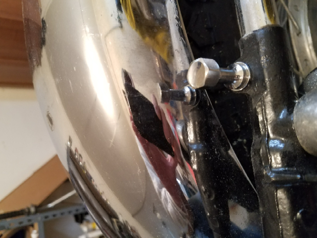

Anyone who has advice on how to easily mount these on the airfilter brackets? Is there a trick?
Got them from ClaussStudios, these guys have great products.

Warm them up and use some dish soap

I got one side started and used a small straight slot screwdriver to push them the rest of the way in

Worked fine, thanks.
