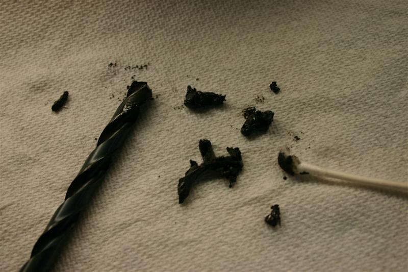

Having just taken three crank shafts apart, and finding all the crud in the crank pins/center bearing recesses, I wonder if these areas act like a centrifugal filter on a smaller scale: they rotate at high speed, the same as the filter. It would seem to me that a detergent oil would keep the impurities suspended, and not be deposited in these crank areas, eventually building deposits and starving those areas of oil. In a recent post, I showed a photo of what I removed from the crank pin, after removing the aluminum plugs. How could the big end of the rod get oil with so much swarf in the rod pins? And how much of this swarf, from a bike that had sat for a while, was slowly breaking loose with hot fresh oil, and circulating around the center crank bearings and rod bearings? Was this build-up a result of ND oil? Since I did not know the history of these cranks/bikes, I'm glad I took the cranks apart for my rebuild.

Dick Eastman wrote:Having just taken three crank shafts apart, and finding all the crud in the crank pins/center bearing recesses, I wonder if these areas act like a centrifugal filter on a smaller scale: they rotate at high speed, the same as the filter. It would seem to me that a detergent oil would keep the impurities suspended, and not be deposited in these crank areas, eventually building deposits and starving those areas of oil. In a recent post, I showed a photo of what I removed from the crank pin, after removing the aluminum plugs. How could the big end of the rod get oil with so much swarf in the rod pins? And how much of this swarf, from a bike that had sat for a while, was slowly breaking loose with hot fresh oil, and circulating around the center crank bearings and rod bearings? Was this build-up a result of ND oil? Since I did not know the history of these cranks/bikes, I'm glad I took the cranks apart for my rebuild.

in my more limited experience with cleaning out centrifugal filters (I have never pulled a crankshaft apart) is that they contain very fine metal particulate, not the carbonaceous stuff shown in the picture. If the crank pins were accumulating material in the same way I would expect it to be the same material.
What is the black material like? Is it hard or soft or gooey etc.? If it were hard and crunchy my guess is that it has been baked by high temperatures but I can't think of any reason that the crankshaft would be particularly hot. Certainly I have never seen anything like this around the exhaust valve guides which one would expect to be much warmer.

If you could collect that volume of metal in the centrifugal oil filter the engine woud be dead. There may be a little metal in there but most of this stuff is just burned or otherwise decomposed oil (blown by the pistons), bits of clutch friction material. There is always some leakage past the pistons and the underside of the pistons are cooled by oil thrown off the big end bearings. If the pistons get very hot then the oil will bake on there and maybe decompose.
The material varied from soft black putty to hard crusty carbon depending on whether it is bathed in oil recently.

The stuff is black sludge. It's a relic of old oil, being there for many years. Once hardened, very hard to remove with chemicals. Only removed by mechanical handling. Believe me, I treid in many different ways, including very powerfull ultrasonic baths.
