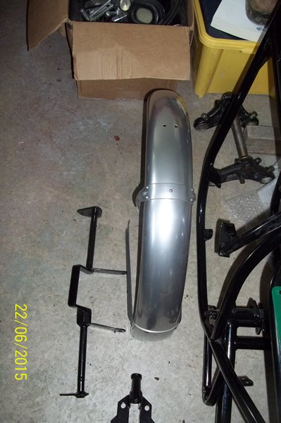

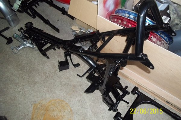

Newly painted frame and parts back
just collected the newly painted frame and parts ready for the build.
Ill get better pics as the rebuild progresses.

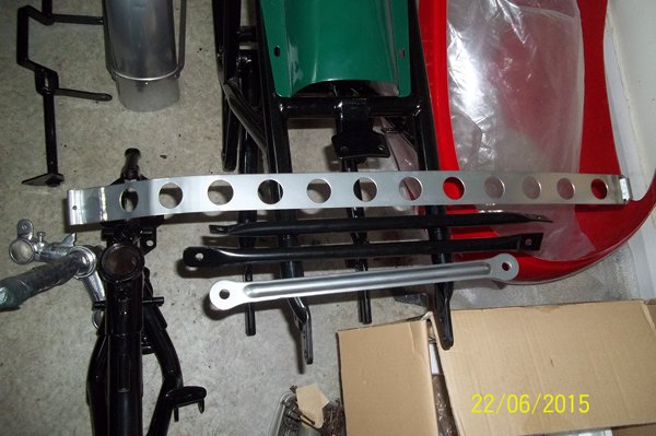

- Frame
- m_100_1542.jpg (55.05 KiB) Viewed 6111 times
- Tank Strap
- m_100_1543.jpg (48.72 KiB) Viewed 6111 times
- Front Guard
- m_100_1544.jpg (48.16 KiB) Viewed 6111 times

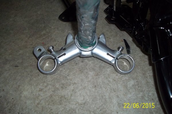

- Bottom Yoke
- m_100_1546.jpg (41.88 KiB) Viewed 6111 times

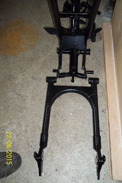

- Swinging Arm
- m_100_1548.jpg (46.64 KiB) Viewed 6112 times
Re: Newly painted frame and parts back
Dave
That's going to look really nice.
lloydy1 wrote:just collected the newly painted frame and parts ready for the build.

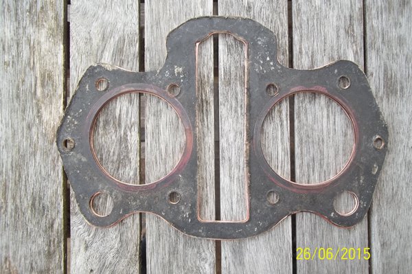

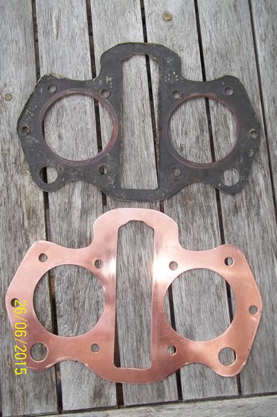

Hand made copper gasket.
One hand fashioned copper head gasket. Not perfect, but should do the job.
- Old Gasket on top of new.
- m_100_1550.jpg (65.18 KiB) Viewed 6015 times
- hand fashioned copper head gasket.
- m_100_1549.jpg (62.06 KiB) Viewed 6016 times

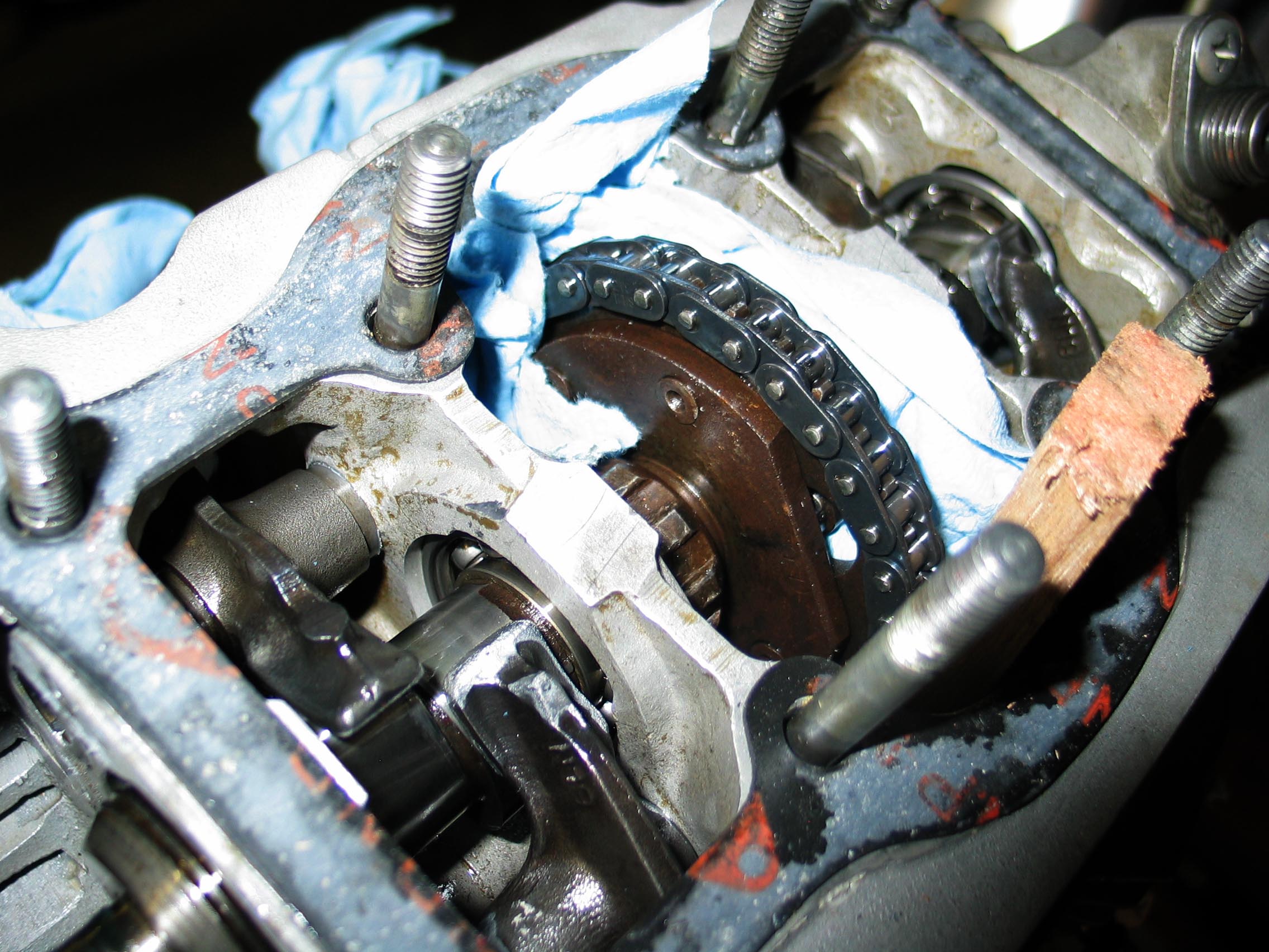

Lloydy1,
I used an adjustable c spanner to loosen the left hand thread cam sprocket nut. I blocked the cam sprocket with a piece of hardwood. Some sharp hits with a hammer on the C spanner did the trick.
https://www.flickr.com/gp/131927779@N07/Cf5m2L
The adjustable C spanner is similar to this one - you would need to check the size.
