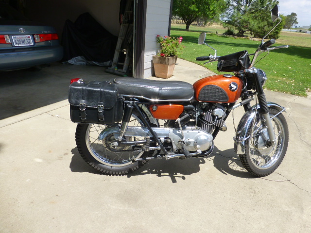

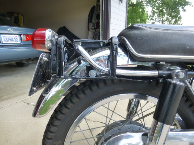

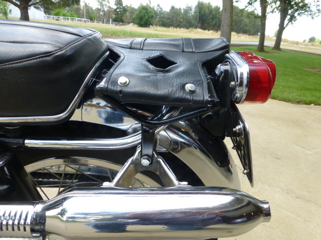

I had a single saddle bag crudely attached for some time. I use it for going to the store for little things and shedding clothing on the road runs. I finally decided to make a proper mount for it, and ended up with a small rack as well. All the metal is recycled from an old hand truck. Looking at it gave me the idea of how to construct it.
I apparently solved the electrical problem. I've used it on two AMCA road runs since then, along with some local riding, and no problems there, although I lost the right mounting bolt and spacer for the rear fender at the grab bar and had to make a replacement spacer.
