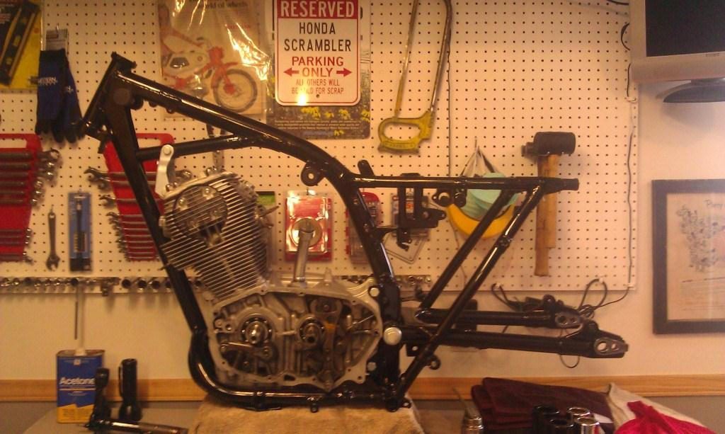

Alright more progress today. I always have my sites set high to get a lot done but then for some reason, it doesn't seem like I get anywhere. This morning I spent two hours blowing a foot of snow--and it is mid to late April for crying out loud. Then, once again, had to talk to Ed and make sure something was right before I put the engine in the frame. And of course, I am glad I talked to him again---or I would be taking it apart for the umpteenth time.
