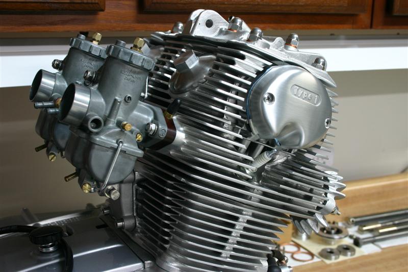

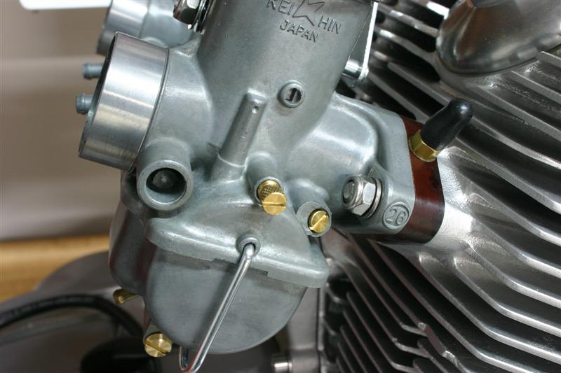

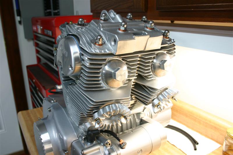

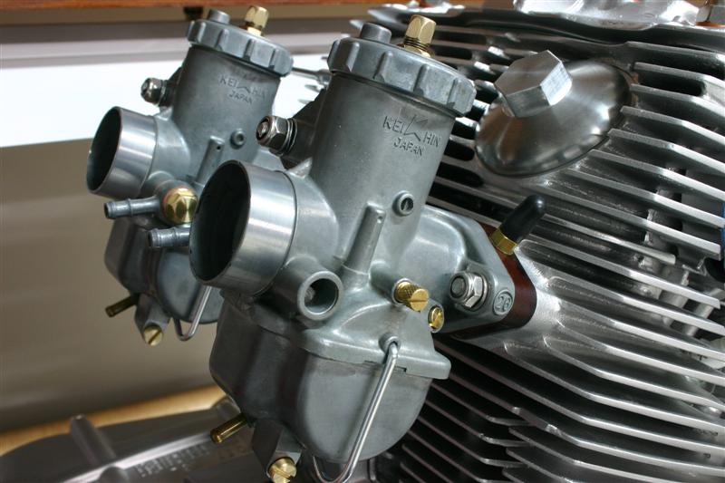

A couple better pics of the carbs; also polished points cover today

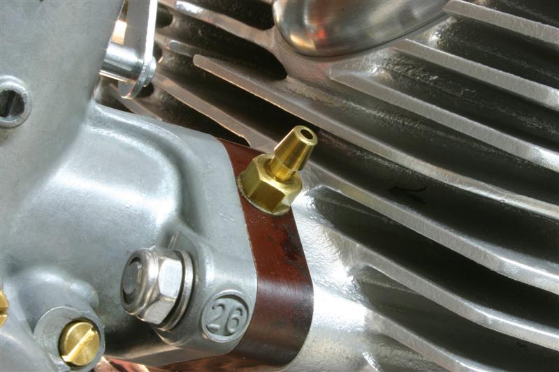

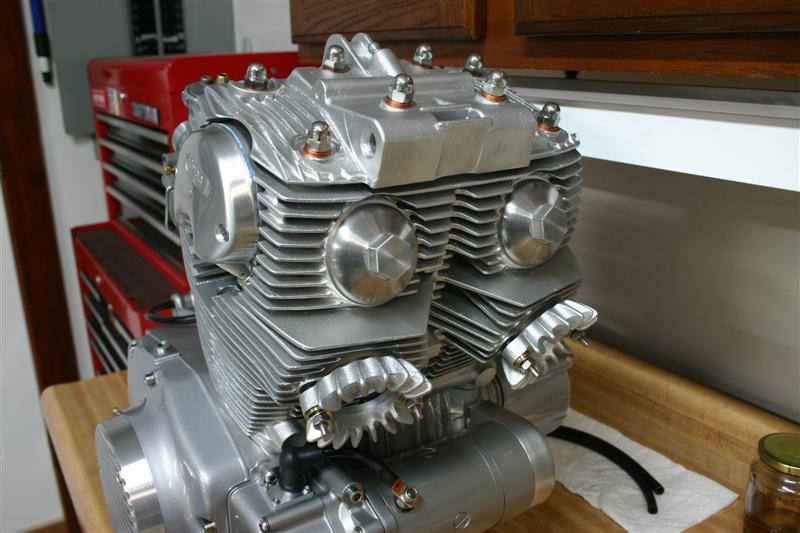

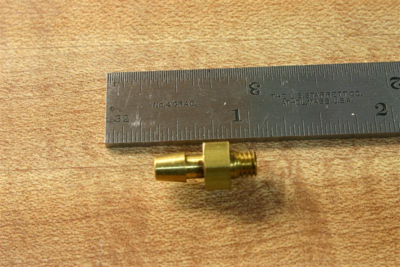

Inquiries about vacuum ports on carb spacers: These were fittings I had on hand, the thread size is 10-32, and location was centered on carb spacer flat. Hole thru is 3/32, counter- drilled with #21 as deep as I could go without breaking thru, then carefully hand tapped. I put these on the spacers to allow use of my oil manometer to balance carbs. I think I put up a post, showing the oil manometer in use; very easy and inexpensive [$5] to make, much more accurate than mercury sticks. I used it extensively on my fours.
I machined the head surface, both sides of the spacers, and the mating side of the carbs - everything flat and parallel for a good seal.

Post by G-Man » Fri Dec 09, 2016 5:46 pm
Excellent work, Dick. The vacuum ports are really neat. Many years ago I built and an 'averaging' water manometer to tune my CB400F.
jensey
Posts: 384
Location: Netherlands
Post by jensey » Sat Dec 10, 2016 11:28 am
Hi,
Nice vacuum ports. I placed them to the inside instead of outside. This way they are hard to see when looking at the bike. I also make them on my CB450's, also pointed inwards.
It saves a lot of hassle, especially on the early 450's (the carbs are known as very sensitive).
Very nice build anyway !

G-Man wrote:Excellent work, Dick. The vacuum ports are really neat. Many years ago I built and an 'averaging' water manometer to tune my CB400F.
Thanks, Graham
I wonder if there is any diff between the two? My oil manometer uses a wood yard stick, 12' of clear tubing, and a few screws/clamps - about $5.
