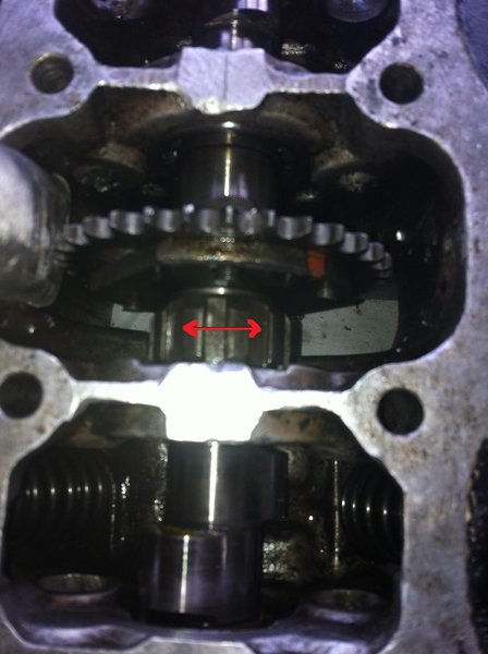

Hi
G you mentioned left hand thread on the lock nut. I am presuming looking at it as I have the picture that it would undo to the right. Not sure which end has the thread on and I don't want to just keep hammering it.
Thanks Dave

Post by Waveblaster » Mon Jun 22, 2015 6:49 am
Lloydy
That splined nut is part of to the sprocket but can rotate to release the right cam . So from memory securing the sprocket and rotating towards the front of the engine clockwise loosens. (Left hand thread).
The small 6mm nut on the end of the left cam shaft can be loosened ( regular thread). I don't undo it all the way to protect the thread and tap it to release the tapered other end inside the centre sprocket hub to release the left hand half of the cam shaft splines.
Shafts and bearings need to be tapped out either side to release the sprocket then pushed all the way though the tunnels.

Post by lloydy1 » Mon Jun 22, 2015 7:03 am
Waveblaster wrote:Lloydy
Thanks Waveblaster. G did tell me it was left hand thread but I was unsure which way he may have been looking at it. Cheers Dave

Cant get this lock nut to undo!!! broken a tooth of the cam cog trying...:o( Ill have to get it to someone who has a bit more know-how than me.
Post by LOUD MOUSE » Mon Jun 22, 2015 8:08 am
If you have vise grip pliers get a grip on the tapered side of the sprocket (other side from lock nut.)
Put the pliers to the front of the head.
Use a flattened tool to drive the nut to the right.
Hit it hard!. ....................lm

Post by G-Man » Mon Jun 22, 2015 10:13 am
Dave
It's not impossible to find a right hand thread nut. Very rare but not impossible.......
