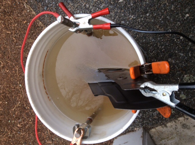

First half of the chain case stripped and in the electrolysis tank for de-rusting.

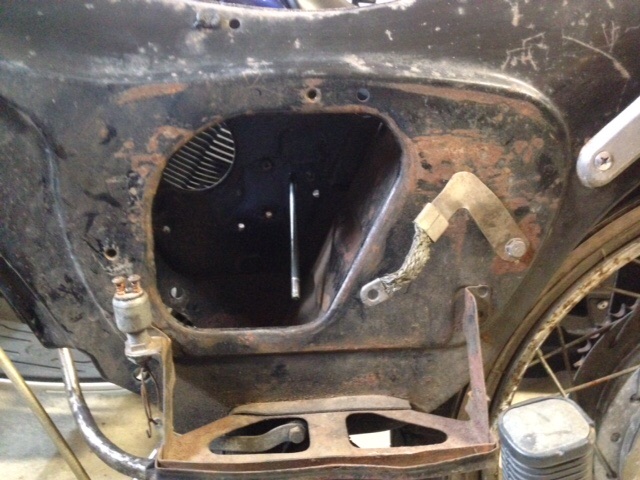

Yes, that cap screw in your clutch adjuster is custom. It's supposed to be an M6 hex bolt. I've used VHT SP127 "Universal Aluminum" engine paint with good success, but it's not very fuel resistant until you bake it on. After that, it's very durable.

Thanks 48lesco; I'll replace the cap screw with a bolt, but I do think the modified cap screw is kind of funky.
I'd read here on the forum about the VHT paint - probably one of your posts - but decided against it because I also read that it was necessary to bake it in an electric oven and I don't have one. Something about humidity in a gas oven?

Thanks, G. That's very kind, but unfortunately I believe it's the thinner, older style battery tray. It's less than 2.5 deep.
