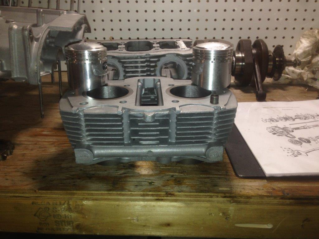

I got my engine back from the machinist that bored, honed and bead blasted it, looks good!

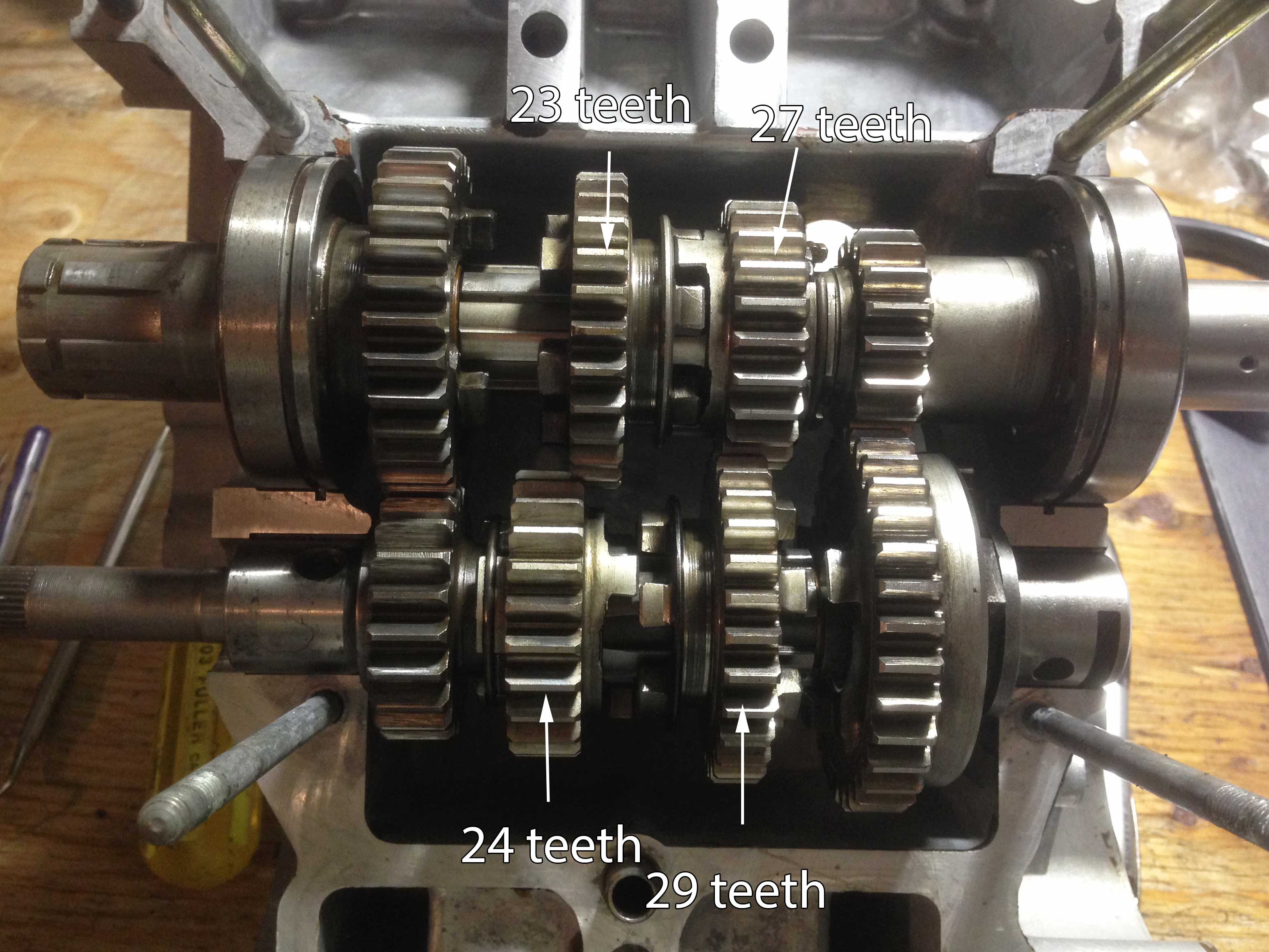

I'm x'ing the transmission, I took a photo and marked the gears, let me know if something looks off. I'm ready to put the bottom end back to together, but I realize I'm missing the knock pins that hold in the bushings in place at the end of the spindle.

X'ing transmission
X'ing transmission

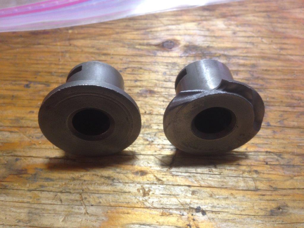

If your bushing looks like the one on the right, you should consider replacing it :)
.5 over pistons
.5 over pistons

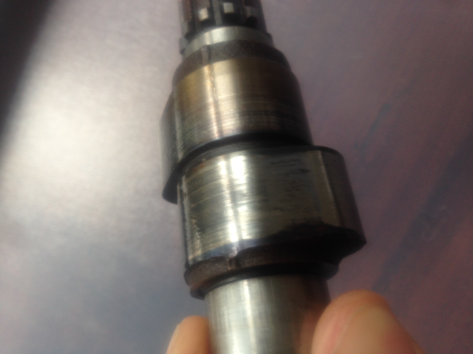

I'm putting the camshaft back into the cylinder head. I wanted to make sure the parts I'm using are okay. One camshaft looks a little discolored/ worn (see photo).

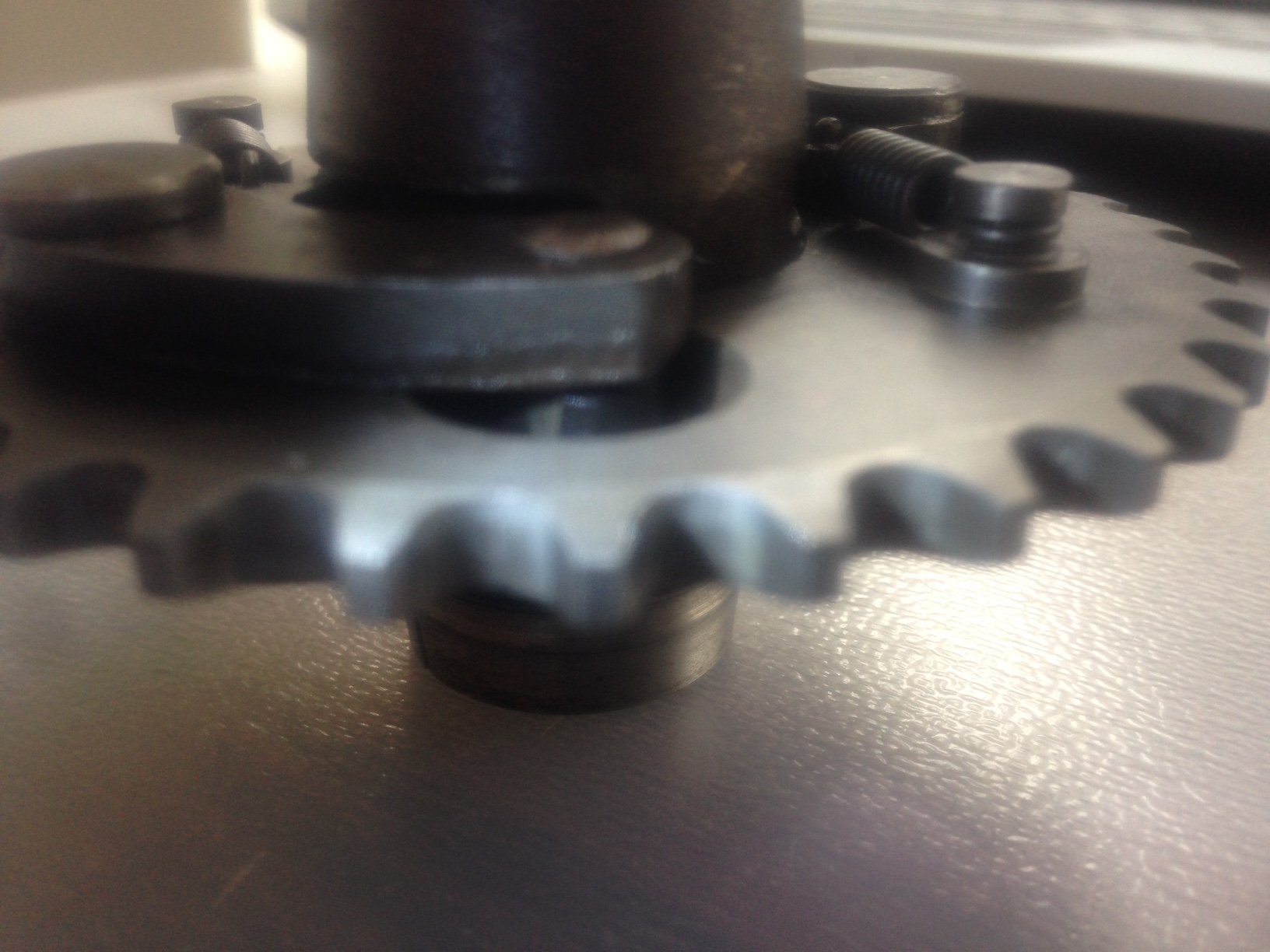

I checked the sprocket for any movement due to loose rivets and it is fine. There is less than.1" play in the weights, should I try and tighten the springs? The thin neoprene layer that is on the pegs under the weights appears to be worn down where the metal makes contact, is this a big issue? I tried taking a photo of this.
trying to take a photo of the neoprene under the weight that is worn down

The sprocket will "TAT-TAP" if the neoprene is gone.
I'd use cloth sanding strip to smooth the cams and I'd for sure look at the followers for wear. .............lm
