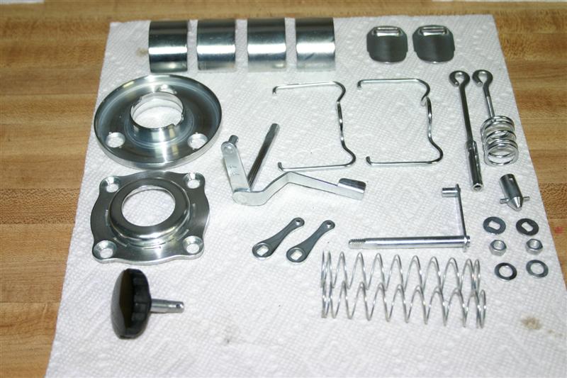

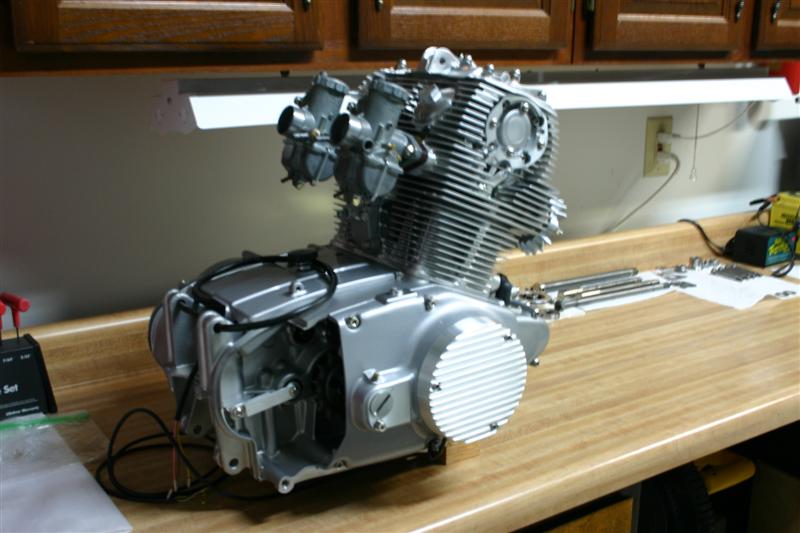

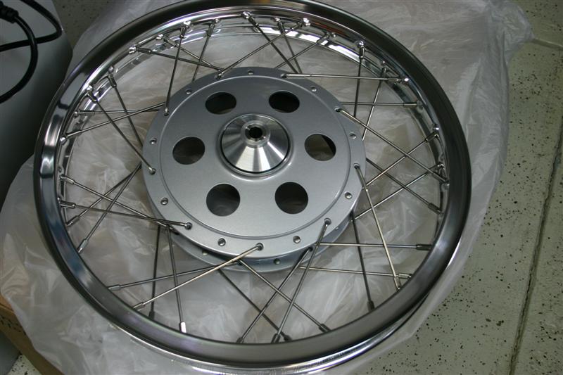

I plated the carb parts and a few other pcs today, with the Caswell zinc kit - pleased with the results. The rectifier in the kit is made by Caswell, and the process requires constant current to be applied at .14A/sq in. The most difficult part of the process is computing the square inches per part, however Caswell is working on a water displacement formula that would require fewer calculations. The max amps out of this model rectifier is 5A, which translates to a max of 36 sq in of surface to be plated at one time. It took 4 batches at about 20 mins each to do what is shown here. Just a few examples of surface area: choke slides - 5 sq in; the two wheel hub plates were 36 sq in, so the rectifier was set at 5A.; float bowl bales - 4.3 sq in; exhaust collars - 21.46 sq in. Caswell recommends accuracy to be within 15%. Also, Caswells tech guy, Jason, has motorcycles and atv's, and was very helpful with a few q's I had. The zinc anodes in the kit should very easily do several bikes.

Nice job. Thank you for all of those surface area numbers; very handy. Calculating those is the hardest part of plating. Your parts came out very shiny; did you use brightener, wire brush the finished parts or both?
Dick Eastman wrote:I plated the carb parts and a few other pcs today, with the Caswell zinc kit - pleased with the results. The rectifier in the kit is made by Caswell, and the process requires constant current to be applied at .14A/sq in. The most difficult part of the process is computing the square inches per part, however Caswell is working on a water displacement formula that would require fewer calculations. The max amps out of this model rectifier is 5A, which translates to a max of 36 sq in of surface to be plated at one time. It took 4 batches at about 20 mins each to do what is shown here. Just a few examples of surface area: choke slides - 5 sq in; the two wheel hub plates were 36 sq in, so the rectifier was set at 5A.; float bowl bales - 4.3 sq in; exhaust collars - 21.46 sq in. Caswell recommends accuracy to be within 15%. Also, Caswells tech guy, Jason, has motorcycles and atv's, and was very helpful with a few q's I had. The zinc anodes in the kit should very easily do several bikes.

Thanks. I used a brightener; mostly came out shiny, but a few had some "streaks", so I used an SOS pad and water [pads are 0000 steel wool].
It's all in the prep - after parts were cleaned in solvent, they were dipped in Works toilet bowl cleaner, then rinsed w/ a baking soda solution to neutralize, and dried - much cheaper and safer than muriatic acid, about a $1.70/qt at box stores.

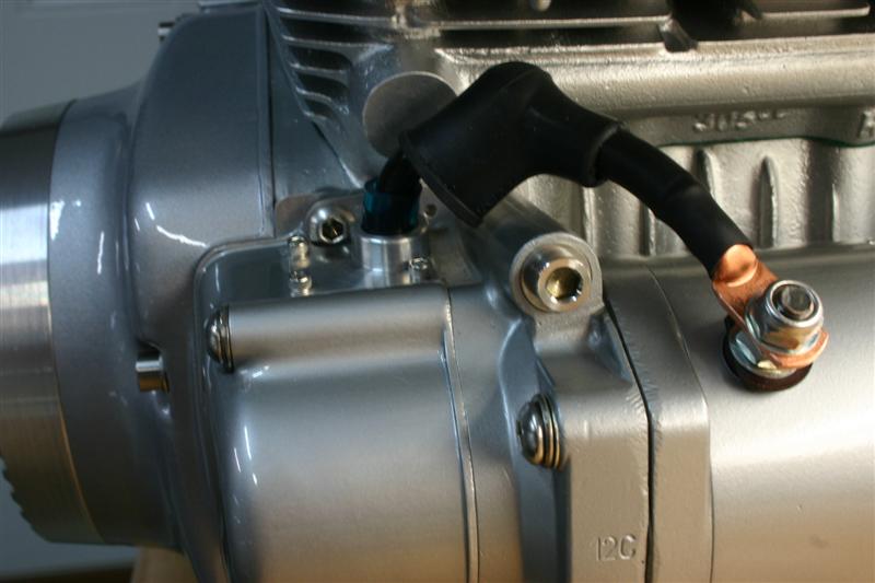

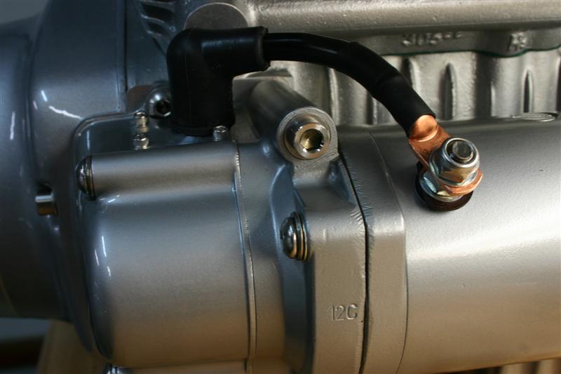

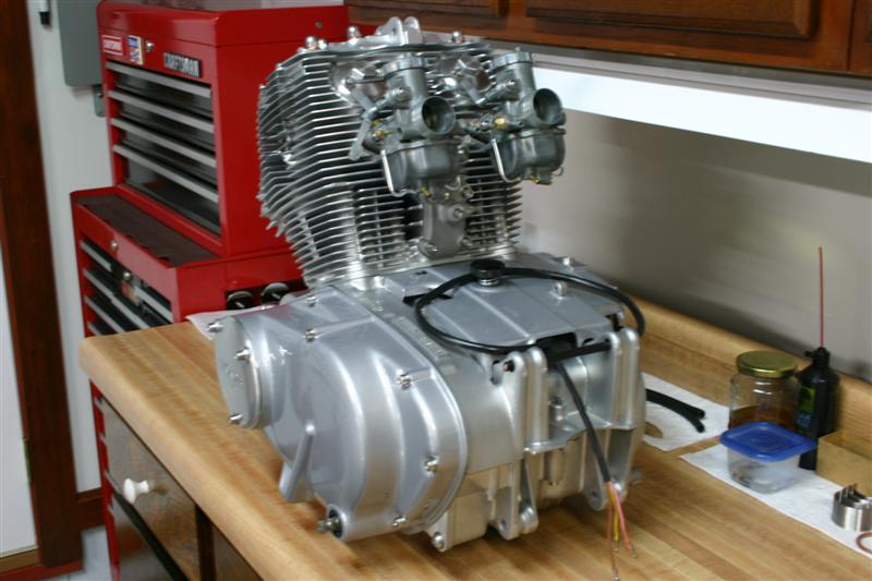

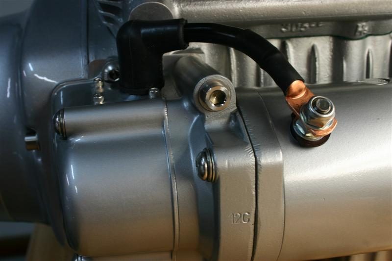

A few more things done - Starter wired up, still need a boot; had to make a bracket, could not find a sealing grommet, so used a distributor boot

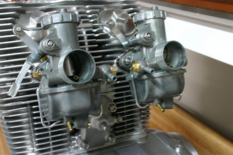

Carbs done/mounted, except for K&N pods.

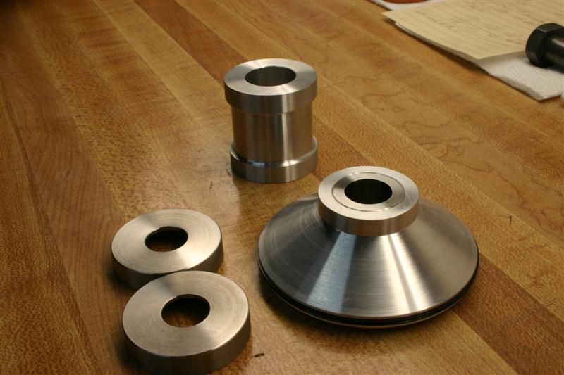

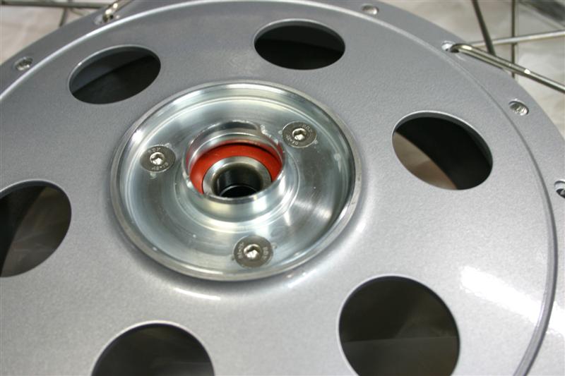

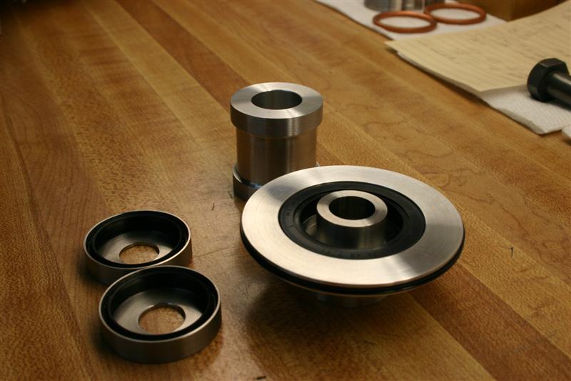

Since I'm not using stock speedo, I made a replacement for wheel-mounted speedo drive; center is S/S, utilizes both rubber seals. Also made new swing arm dust caps from S/S, rubber seals from original; made a new rear axle spacer while I was at it, aluminum.

I see that the carb bodies and bowls look like they are new. I looked back in the thread but could find no reference to how they were cleaned. So, how were they cleaned?
Thanks in advance.

I'd like to know too, if you don't mind. Also, how'd you clean that engine so nicely?
