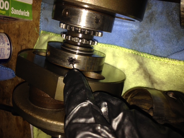

Well this isn't good. There's no doubt this was a big source of my dry piston problem. Much worse on the right than on the left. Luckily everything on the crank still spins true and free...

LM, I'm using carb cleaner and an air compressor. Appears to be cleaning the crankshaft ports and gaps just fine with a couple passes of each.

Post by Brickyard » Wed Oct 21, 2015 9:59 pm
G-Man wrote:Brickyard
That is blocking the splitter which shares the feed from the oil filter to the left hand bearing with the right hand and would account for the lack of lubrication to your right big end and piston.
It looks like general sludge and perhaps parts of your broken-up tensioner wheel. You need to take a careful look at your right hand main and big-end bearings. Run a cleaning brush through the holes at that point and any other. The dirt / debris will have gone further than that plug of material you have in your hand....
What does the inside of the oil filter look like?

G, in the area you circled in red, I found what looks to be a gasket or dried gasket maker. Please confirm whats in my hand should be in my hand and not in that area you pointed out...
G, the "sludge gasket" happened to look and feel like a legitimate seal, and I was worried that by pulling it, I'd lose integrity somewhere else.

Hi Brickyard
You will find that the sludge in this hole will have found its way into the big end bearings and will have reduced the life of your crank somewhat. It is possible to strip and clean this but you do need some tooling. To avoid problems in the future, I think you need to get it properly cleaned and you cannot really do that without taking it apart. You may be able to find a specialist who can do this for you.
The reason that your piston was not being lubricated is because the oil supply to the big-end is blocked by that debris. Beyond the oilway you show in your picture are a whole series of oilways that get oil to the hollow big-end pin.
Take a look at my CB72 restoration thread to see what you are dealing with. The crank may feel OK but I find that difficult to believe judging by the lack of lube at your piston. Sorry to be the bring of doom but now is the time to fix things if you don't want to be doing it again in a few weeks time....
