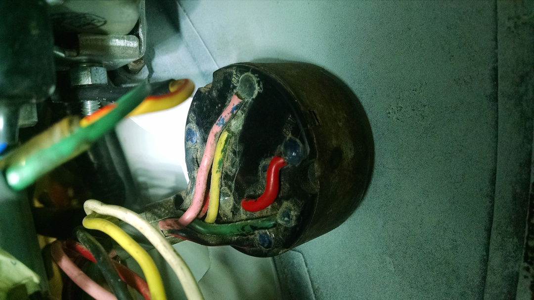

Here is the ignition switch. The two IG black wires are in the back of this switch and can't really be seen. When I bought this bike, it came with an aftermarket 3 way switch that was difficult to make work correctly.
I bought a stock one from a friend who had several CA72s in his collection. The only difference in this switch that I can find is that it does not have a brown wire labeled ML. There is no spot labeled ML at all. ML corresponds to the speedometer light bulb as per the wiring diagram.

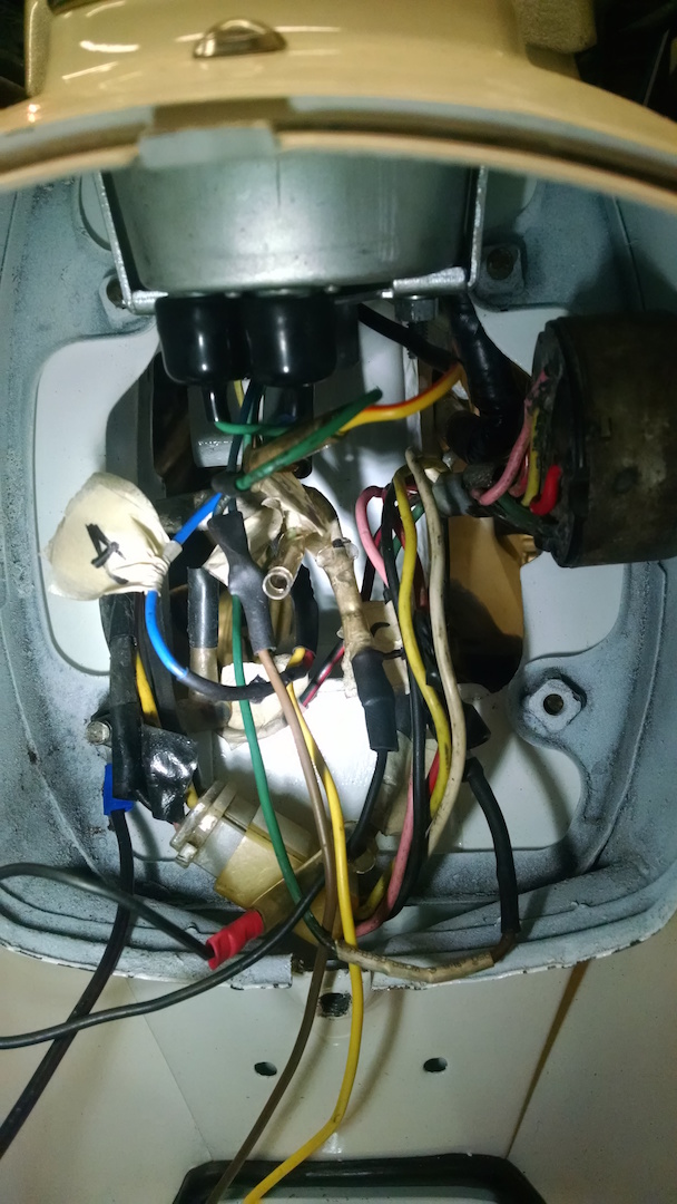

This is a picture of the headlight bucket wiring. It's a bit of a mess but I'm able to make out most things.
The brown, yellow and black wire are leaving out the bottom of the picture to the headlight bulb.
Yellow is high beam and I have it 3 way soldered into the headlight bulb indicator of the speedometer.
Brown is the low beam and is 3 way soldered into the speedometer bulb that's always running.
Black is the earth and is grounded to the frame in the lower left hand with an eyelet with a blue bottom.

In the above photo, the unused open female end is the light green/red neutral light spot. I took it out for the use of this photo. I have never had the neutral light installed (one black wire, one green/red) as because I do not have a rubber bulb holder for the glass eye in the top of the bucket.

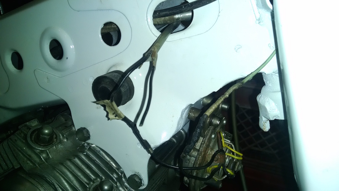

Here, I who the unused black wire that was cut by the PO. I cannot find this wire on the wiring diagram and it doesn't correspond to anything that I'm aware of. It is live with 12v when the ignition switch is turned on.
When this bike was built the first time, I left it open because it made no difference in the use of the bike. The horn is hooked to this other black wire and then the other end of the horn is connected to the handlebar switch.
