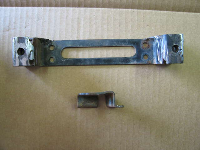

BTW, just for general reference, here's what the '61 bracket looks like that came off the seat I have at the moment. You can see that the bracket is not as long in the hat area as the 62+

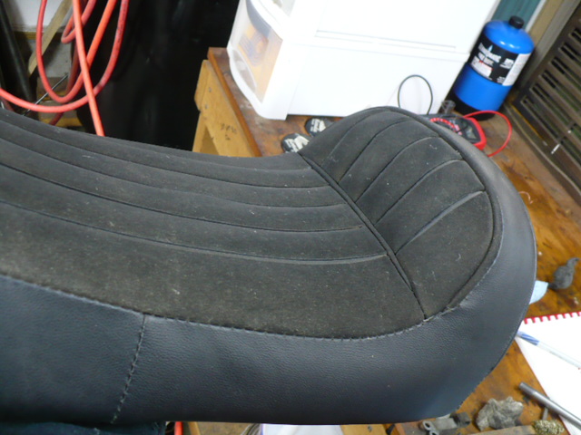

I'm not sure about other seats, but I'm quite sure the cover that was on mine was original. I just wanted to point out that there is piping on the original cover. One between the two inserts. And another at the rear. I don't know if that was a 61 only thing or not, but I noticed that the one on eBay didn't have it. Refer to the pics in my threads.

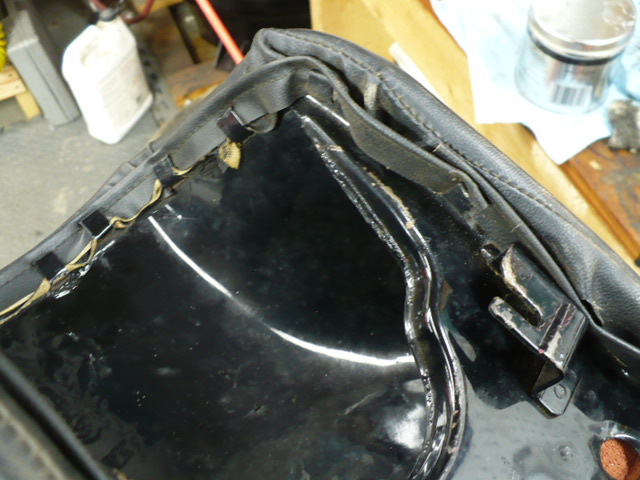

I noticed a number of unique things on your 61 seat as oppose to the others. It looks like they streamlined the production as things went along. Your tack strip is even unique as it has extra tabs that fold over the material after they are tacked down.56_oval wrote:I'm not sure about other seats, but I'm quite sure the cover that was on mine was original. I just wanted to point out that there is piping on the original cover. One between the two inserts. And another at the rear. I don't know if that was a 61 only thing or not, but I noticed that the one on eBay didn't have it. Refer to the pics in my threads.

So far everyone that's mentioned interest has give their material deposits so everything is rolling steadily along. The brackets for the seat will be made tomorrow and should hopefully be here next week. Pending an approval on the seat mold, I will be test fitting the brackets next week and making any final adjustments if needed. They will be then sent to the powder coater for a coat of semi-gloss black.

Isiah, you haven't asked, but I'll put a new bracket on the rear of your seat so you can fit it on your bike properly since you don't have a 61 frame.

The only piping on my seat is in 2 places, one piece where the backrest piece of suede meets the flat "sit your butt down" piece of suede and the other is on the radius of the backrest piece of suede. I also have the 2 sets of tabs like on 56oval's. I believe mine to be an early to mid 60's issue because there is no part number or model number stamped in white paint on the bottom of my pan.
