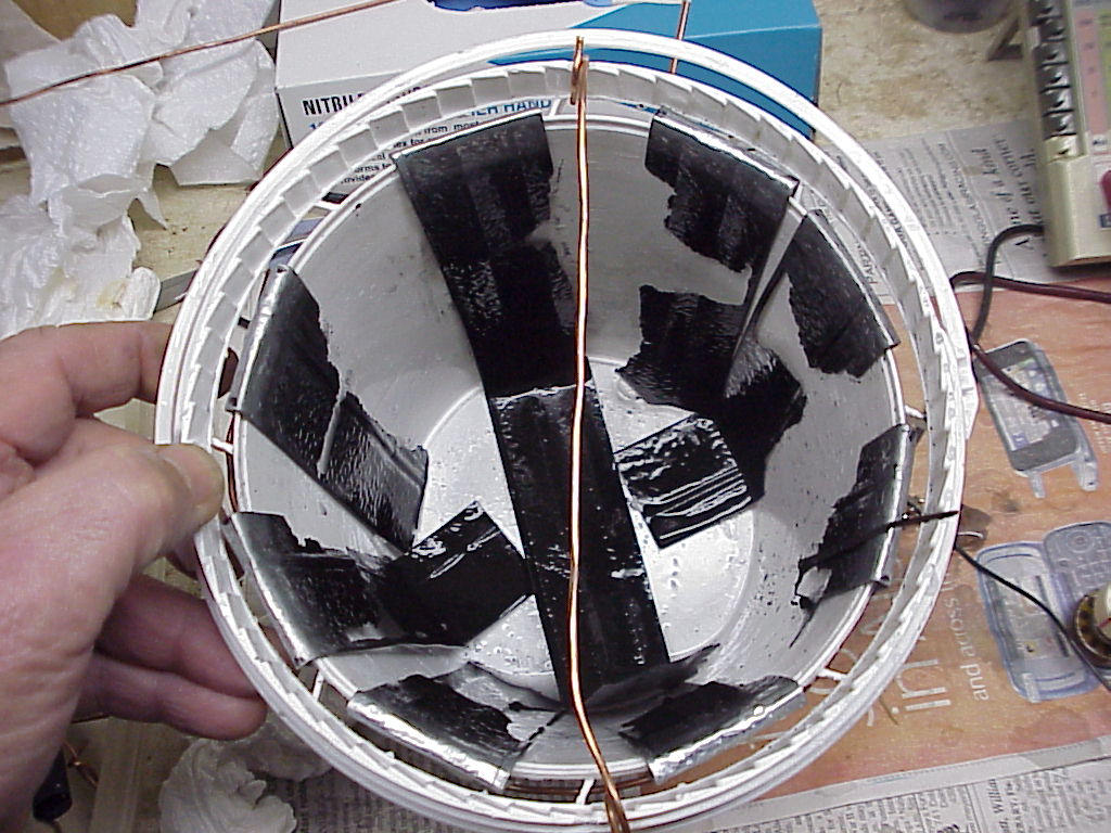

My cathodes are starting to disappear. One is almost cut in half. One of the small cathodes I made for doing the ID of bushings has a hole eaten in the side. I would say that if you plan on doing a lot of parts, you will need the 50 ft roll you got, Zoom. I'm going to hang on to my package of strips because I have other bikes to do yet.

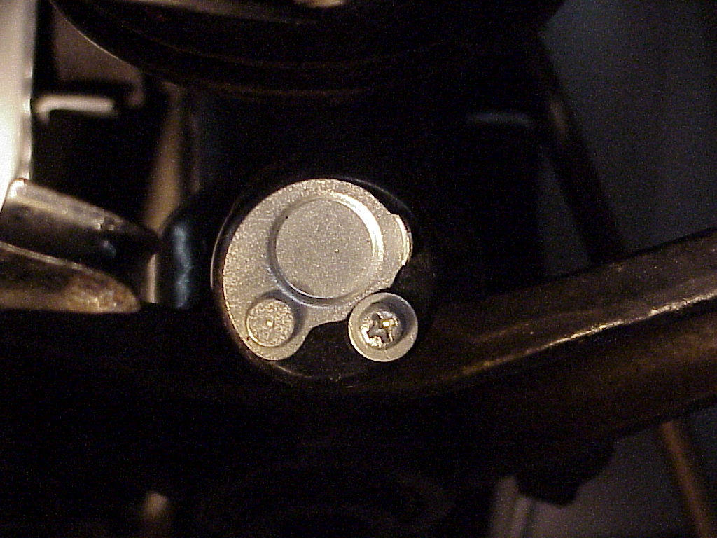

The first was that little trap door and the tiny screw and washer for the cover that goes over the front fork lock on my CL77. My trap door was in perfect shape, only rusty, as was the screw and washer. I sand blasted the trap door front and just wire brushed the back. Back was still plated. The door is riveted in place on the plastic sleeve that makes up the cover. Did not want to ruin the original rivet. So, I just plated it in place. Came out great, as did that tiny JIS screw and washer.

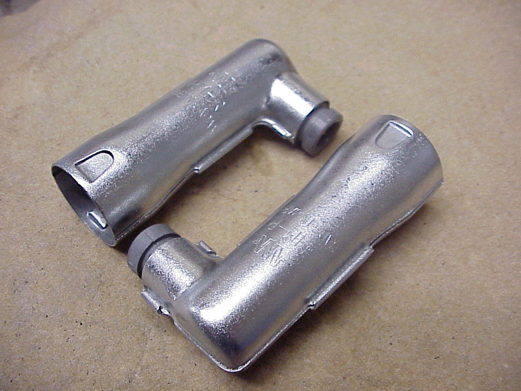

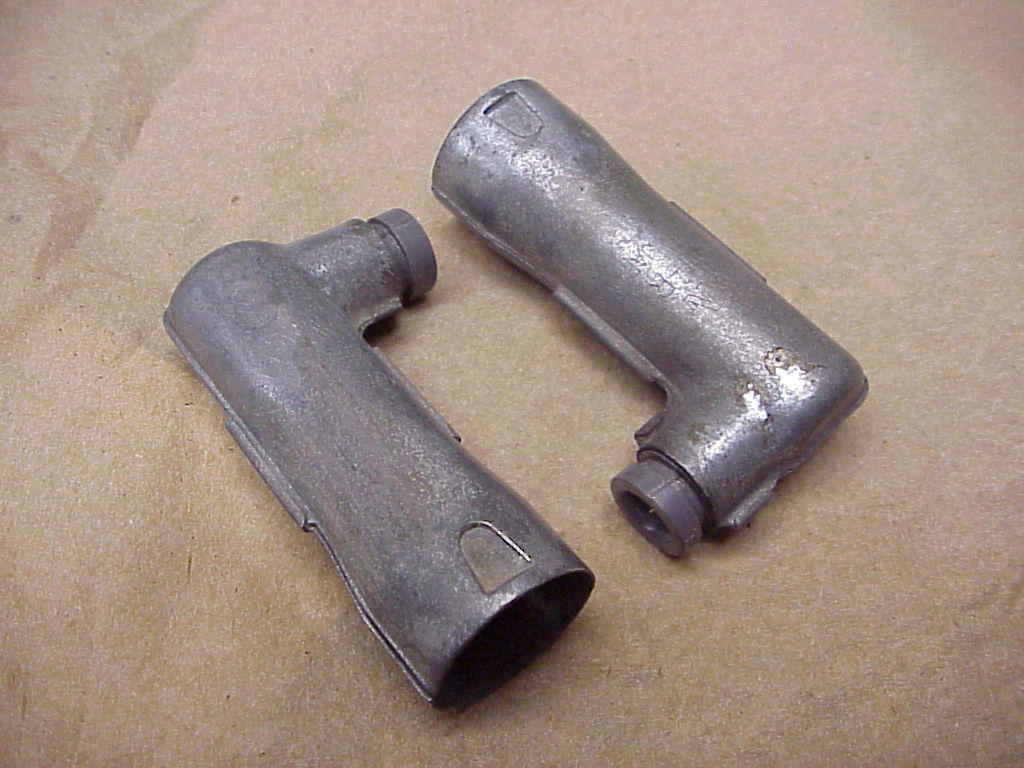

But the best was yet to come. The two metal shielded spark plug lead ends looked old and crappy. Not rusty, but gray, plating missing... ugly. So, I dipped a rag in acid and cleaned them up as best I could. I then wire brushed the daylights out of them with a soft (Harbor Freight, made in China by prisoners) steel wire brush). Then into the plating bath. 20 minutes each, carded and back in for a second coat of 20 more minutes. Did them individually. Attached are the before and after pictures of my plug ends. Note that the OEM markings are as crisp as they day they were made.
I've also attached a pic of my tank and cathodes. They are pretty much done. Need to make a new set. As I walk around the bike I see all kinds of plated parts that need sprucing up. I even replated the phillips head oval head screws that hold the points cover in place. They were pretty rusty. I hammered the slots back into shape, sanded the oval head in the lathe and in the bath they went. What a difference. No longer do I have to worry about finding oddball fasteners. I'll just fix mine. This will be a big savings when I get into my '66 Bonnie that has many Whitworth fasteners.
