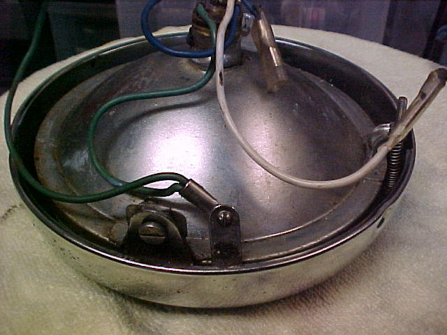

Screw connector goes to the chrome headlight trim ring. There should be a tab with a hole for it to attach to.
1964 CB72
