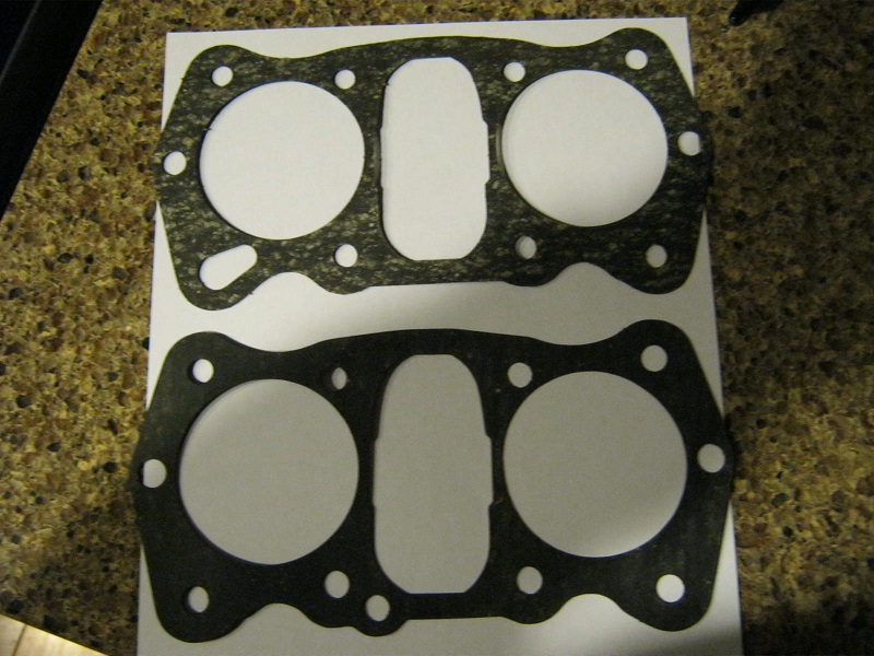

Yep, two different types, you have an early style gasket on a later style barrel. : (

Re: Oil Leak Problem Figured Out
Post by LOUD MOUSE » Mon Feb 15, 2016 6:27 am
Yes.
You have the early issue which was used with the 8 hole cylinder where the oil went direct to the LS stud and cross over on the cylinder.
The correct gasket for your engine has 9 holes. ...................lm
Steverino wrote:I wish I would have noticed this when I installed it. I have the wrong gasket. I'm glad I was putting plenty of oil to the top end on the first fire up. Is there an early and a late gasket?
Steve
ImageKIMG0436 by Steve Steverinomeister, on Flickr
ImageKIMG0433 by Steve Steverinomeister, on Flickr

Post by Steverino » Wed Feb 24, 2016 1:30 am
Finally, after two long weeks of waiting, my gasket finally showed up. Two weeks to get here from Texas. I figured it would take the usual 3 to 5 days at the longest to get here. I ordered a mud flap for the 1100 from the UK that got here in less time. I will never make that mistake again.
ImageKIMG0462 by Steve Steverinomeister, on Flickr
Now that's more like it!
ImageKIMG0463 (1) by Steve Steverinomeister, on Flickr
I put the motor back together today and I hope to have it mounted back on the bike tomorrow. I am looking forward to posting a video of it sitting there running nicely once I get everything buttoned back up.
