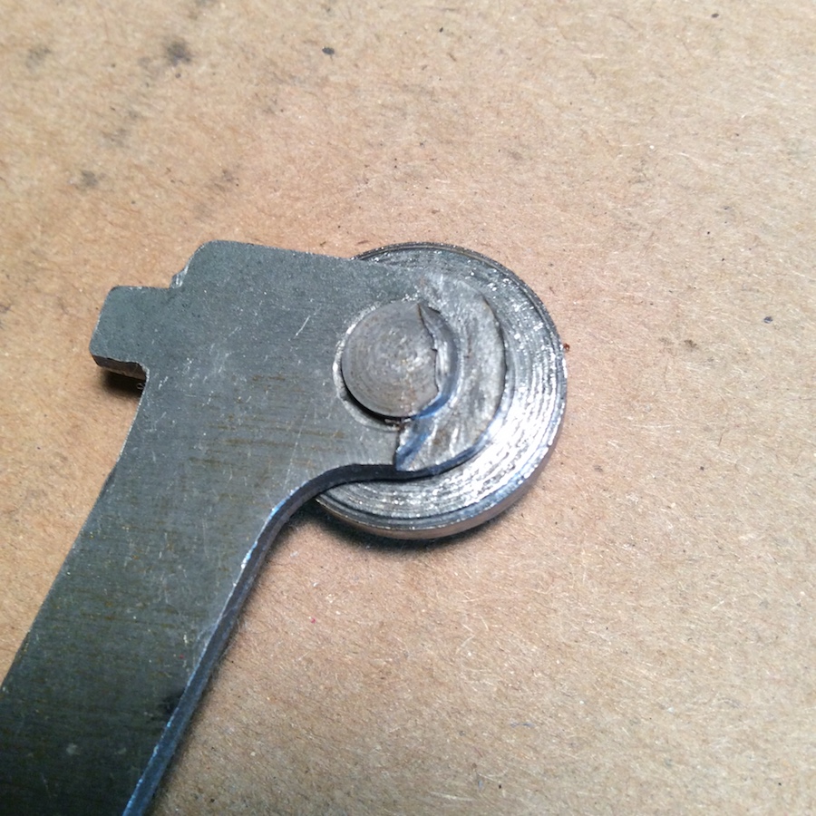

Well, if anyone has seen my thread in the Transmission section, you'll know that on my first ride attempt, my shifter was sticking - not returning - and I couldn't get above 2nd gear. With a lot of help from Loud Mouse, I think the problem is now resolved with a new shift spindle. I also found a bent drum stopper that was forcing the wheel at its end to sit in front of the shift drum instead of seating itself in the drum indents. This must of been going on for some time because the back of the stopper was quite scarred. I cleaned it up, bent it back into shape and reinstalled.

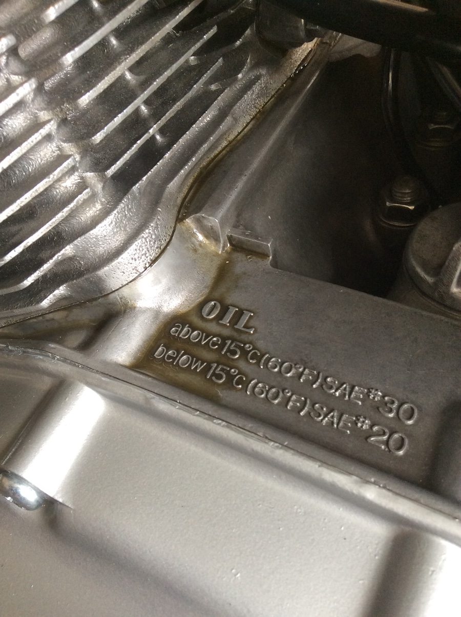

I took the bike out for a 5 mile run this afternoon and it shifted very well, both up and down the gears. It ran quite well too. Upon return, I found a tiny oil leak and, more importantly, I found that my swing arm nut was undone, hanging by a few threads and the bolt was coming out the other side. Losing that could have hurt. Maybe a little loctite in the future, but I'll have to keep an eye on it.

Check the bolts at the cam tensioner. ............lm

Just checked the cam tensioner bolts. You were so right, LM! Hardly more than finger tight. I could see oil at the gasket. I also cleaned paint off of the swing arm bushings, cleaned the thread, applied a little loctite and torqued.

The leaking oil issues seem to be resolved. The clutch case gasket area is still dry and tightening the cam chain tensioner bolts seems to have done the trick.
