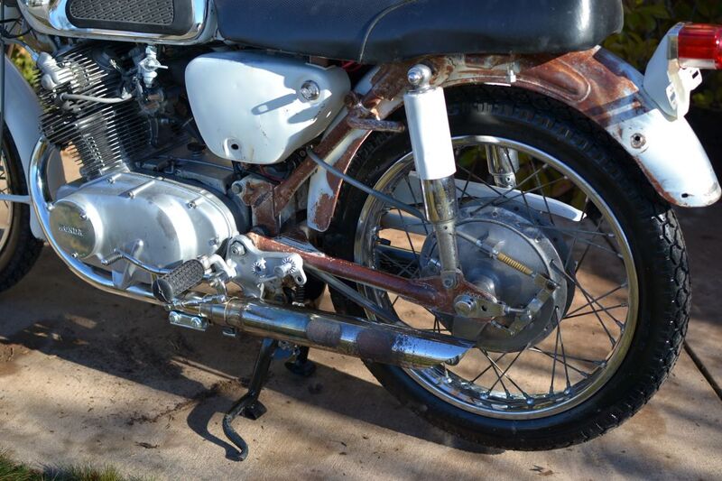

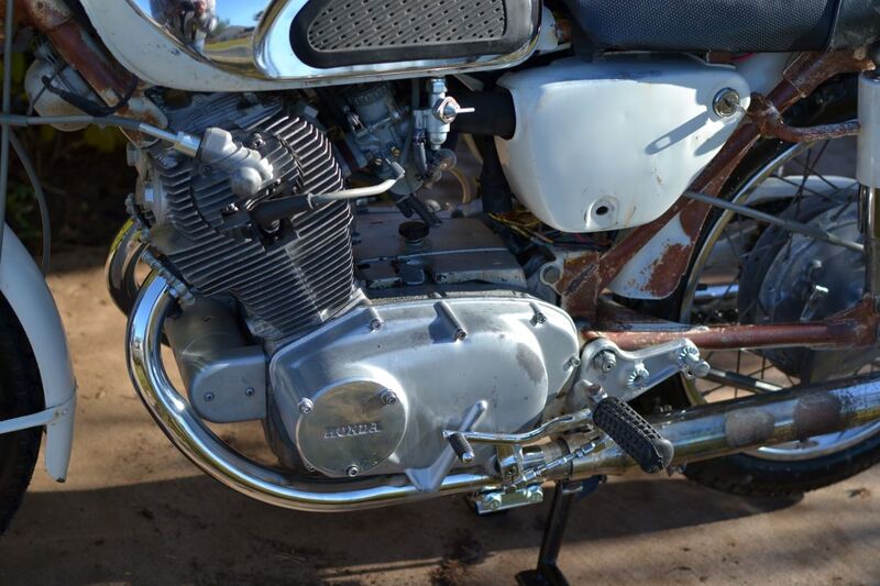

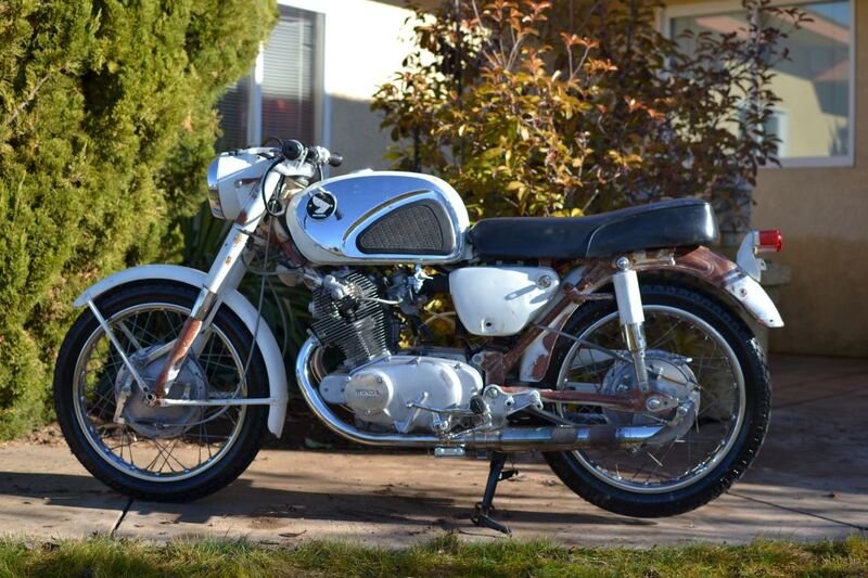

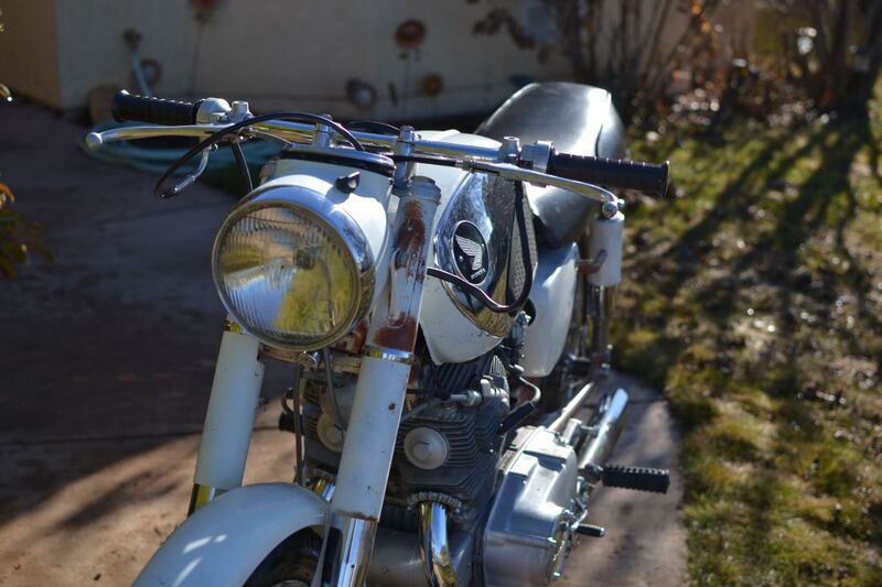

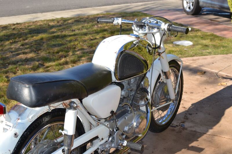

Re: Bill's CB77 Retirement Project
There's a lot of things I wish I had taken before and after pictures but since it seems like I have do to everything twice I usually have more than one chance. My 65 CB77 project update is not too much progress. I have fitted almost everything back at some time or another. It keeps coming apart. I have fitted the old Harley Davidson aftermarket mufflers to the bike. It sounds wicked. Cables are all in and working. Tach is moving but not even close to correct, Still trying to get the carbs sealed up. The main issue now is the clutch is STUCK. I've tried everything so now I'm going to tear it down. I'm looking for a mudflap with brackets and a sidestand. Please let me know. Here's a few pics of the current state of the bike.
