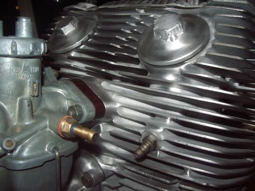

Nothing much to report to date, I've been stripping the engine and today's discoveries include a bent inlet valve and four totally goosed tappet covers, they were so tight that the correct socket torqued out after I was reduced to getting my neighbour to lean on the head while I tried to undo each one in turn using a breaker bar. I ended up notching the outer edge and hammering with a 2 1/2 pound hammer and punch. This is shaping up to be one expensive repair. but on the other hand it has to be absolutely right or it's not worth doing.

Progress is very slow at the moment, my wife took a tumble 10 days ago and broke a bone in her foot leaving me as chief cook and bottle washer, so my time is severely limited. All I have managed today is to loosen off the camshaft nut, it put up a pretty good fight and was just as well I'd done my homework on this excellent forum because it would have been an impossible task had I not known that it was a left hand thread. Tomorrow I will tap it out then set to work removing the valves.
