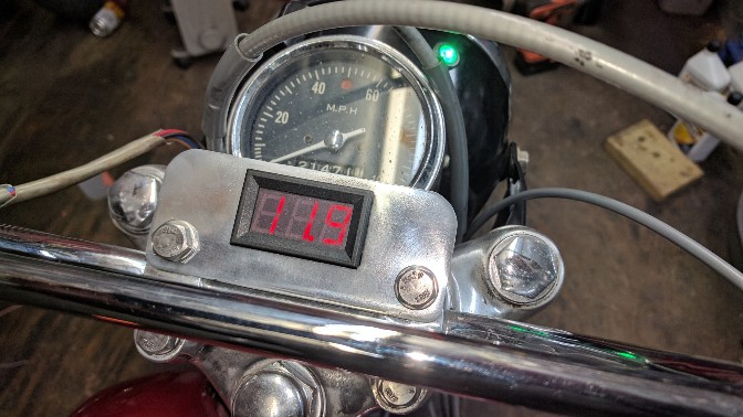

I was a bit apprehensive about running with the lites on..... Previously I had installed an xs400 headlite with a 35/35W bulb and then upgraded to a modern Onan style rectifier regulator. So today I mounted a digital voltmeter in a handmade polished bracket. It runs 12.3- 12.8 volts all the time, with lites on. I think I'll keep it on and monitor it to see how she does!
The pic was taken after I had been messing with it and Drew it down a bit. I don't leave the key on and overheat the coils, to be sure, but these batteries are kinda small on the scrambler!

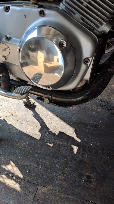

The stator cover is good enough for the girls I go with..
I wet sanded with 320 and ran it on my buffer..
I wouldn't want it to be perfect cause the rest all sucks lol.
I think it's pretty darn Nice.. I left the dent in. Character.

Post by Seadog » Tue Mar 21, 2017 3:09 pm
Lookin' good.

Thanks loud Mouse I love it
