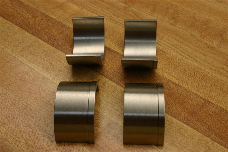

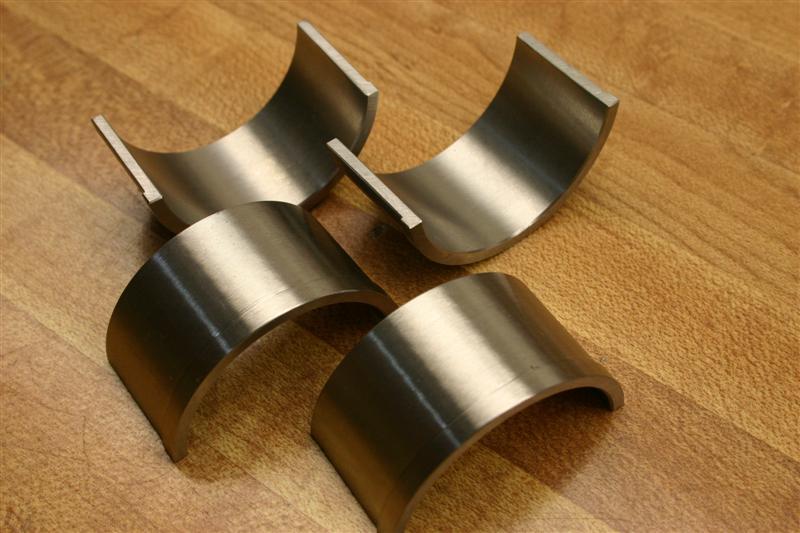

Post by Dick Eastman » Sun Nov 27, 2016 4:09 pm
More stainless - I made these exhaust collars today, from 304 S/S seamless tubing:

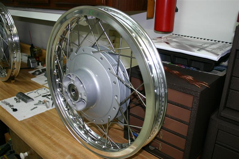

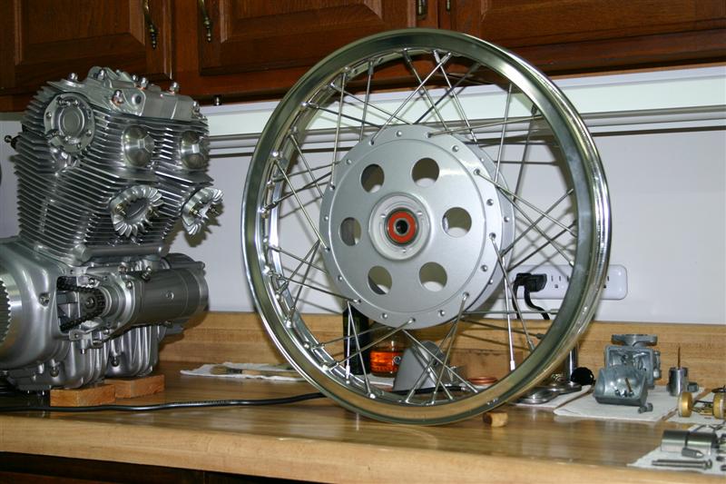

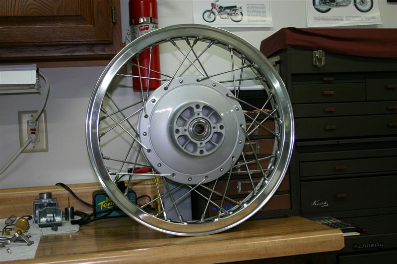

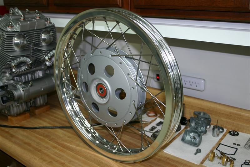

Post by Dick Eastman » Tue Nov 29, 2016 7:01 am
I received my wheels from Buchanans Monday - they did a very nice job. The hubs are the same paint/color as side covers; paint is single-stage urethane. I went with stock sizes on the Excel rims, which are Akront copies [wheel of choice for track bikes from the era]; WM1 front, WM2 rear; 9 guage spokes rear, 10 guage front, S/S. Now for tires/tubes...
