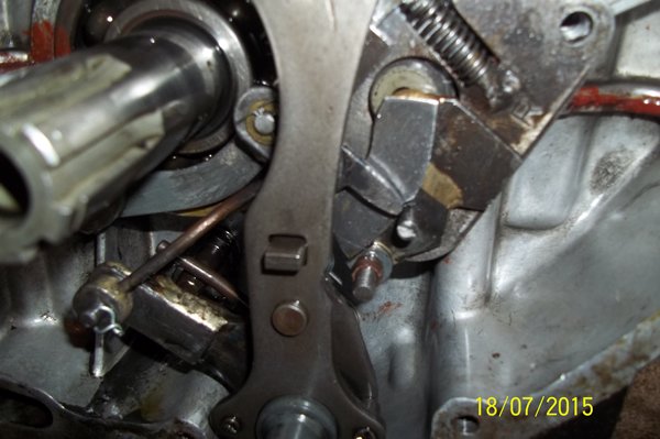

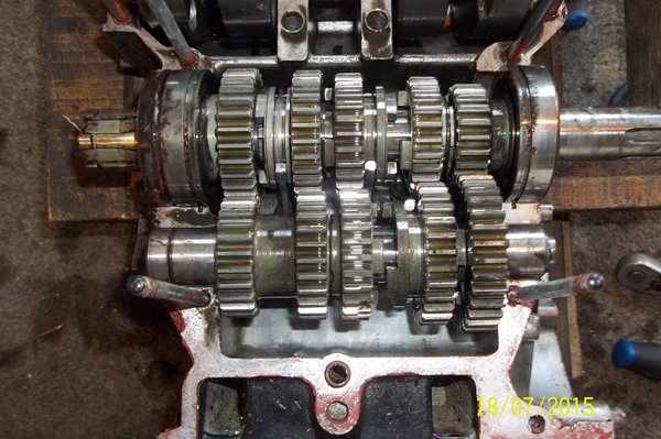

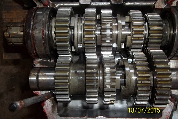

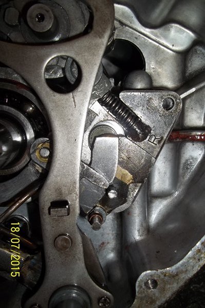

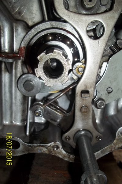

Post by lloydy1 » Sat Jun 20, 2015 10:24 am
Some pics of the gear changer and box.
Looks pretty standard to me, other than the gear change mechanism. Any thoughts please?
Cheers Dave
