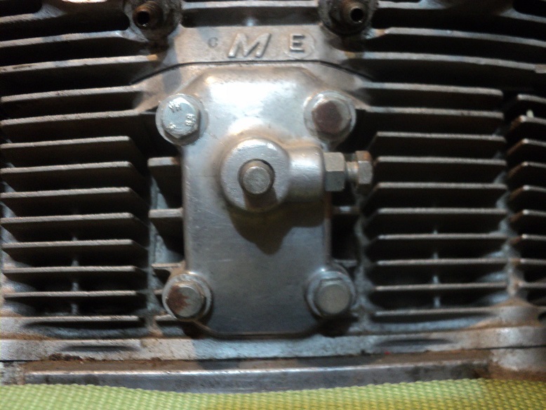

Post by R100 » Mon Jul 13, 2015 2:12 pm
LOUD MOUSE wrote:The photos show 2 issues of tensioner.
One (left) is the first issue with the set bolt on the left side. (first issue) But has the third issue spring and tensioner bar.
Right came along at engine number 105099. (issue 3)
You can see the set nut is on the right side and angled down a bit.
There is a third issue (issue 2) with the set bolt on the right and used the large aluminum mount.]
This is my tensioner that I wish to replace. Am I correct in thinking this is "issue 2", set bolt on the right (not angled), large mount?
swingarm 003.JPG (68.59 KiB) Viewed 4210 times

Post by Hoosier Tom » Mon Jul 13, 2015 2:29 pm
R100 wrote: This is my tensioner that I wish to replace. Am I correct in thinking this is "issue 2", set bolt on the right (not angled), large mount?
Yes.

R100
Posts: 332
Post by R100 » Mon Jul 13, 2015 2:35 pm
Thanks HT.
The gasket from my gasket kit fit it correctly.
I am wondering how to determine which version the various sellers on E-Bay are offering. The pictures usually are not definitive, and I doubt they are all that knowledgeable on the differences among the three versions.

Post by R100 » Thu Jul 16, 2015 8:19 am
Can an "issue 3" tensioner (set nut on the right side and angled down a bit) be used to replace an "issue 2" (wide mounting plate), or are the mounting surface and bolt pattern too different?
