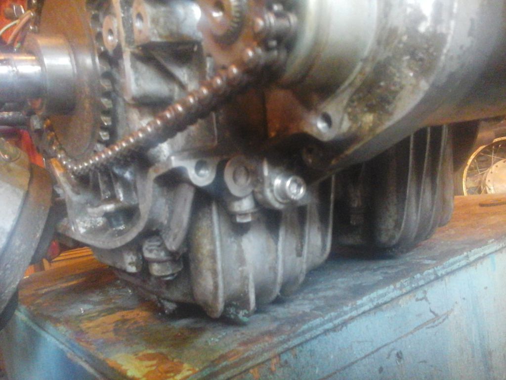

adjusting starter chain
- I fitted a 40 thou washer behind each of the starter mounting bolts.
Before the washers were fitted the chain was rubbing on the bottom of the case. I fitted a 8mm washer instead of a 6mm. - 1024x768_bestfit (13).jpg (97.82 KiB) Viewed 4734 times
