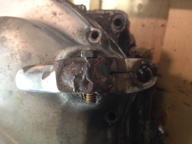

Thanks LOUD MOUSE. I just wanted to clarify that the part with the welding on it in this picture (see below) is the "Gear Shift Spindle" and not a Gear Shift Arm. Thanks for the advice.

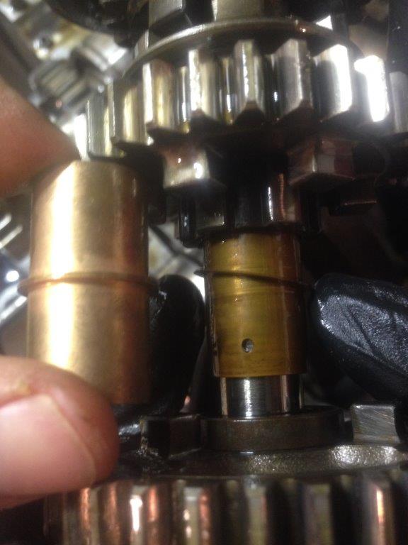

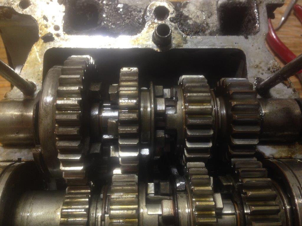

I split the case and I'm glad I did, the bushing that is known to wear down was in awful shape (see photo below). I also realized that there was no kickstart prawl, at all... I did get a new bushing and kickstart prawl, so I'm covered there.

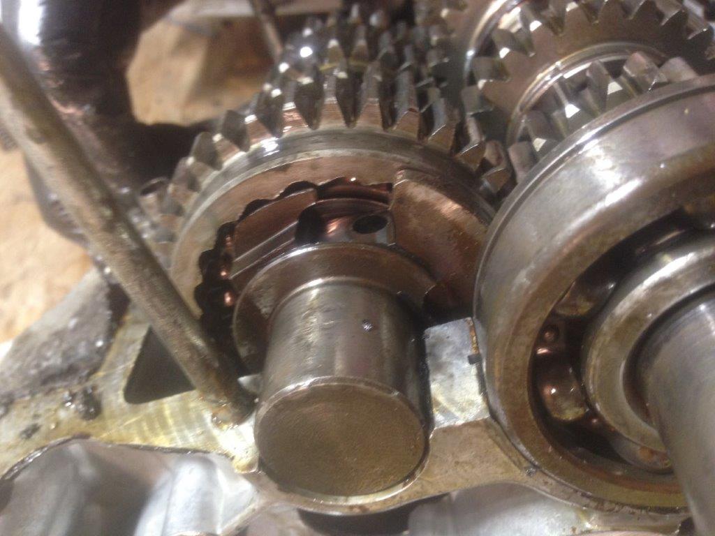

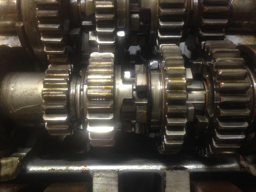

I took some photos of the overall transmission, what else should I be looking for in terms of parts that often need replacing? I can take more photos and post them if something doesn't look right.
Thanks all.

Transmission
Transmission
Transmission
Transmission

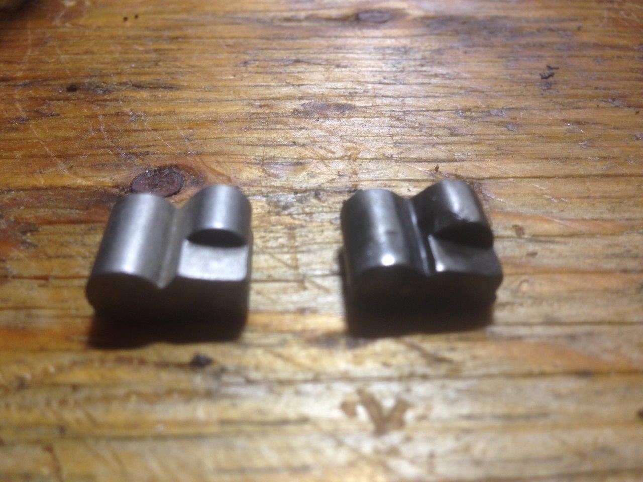

I took of the oil pump and my missing kickstart prawl showed up! It just fell out, any idea how this would happen? Have you seen this before?
