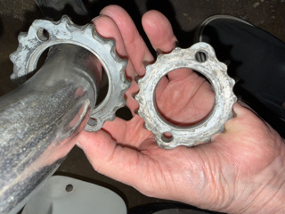

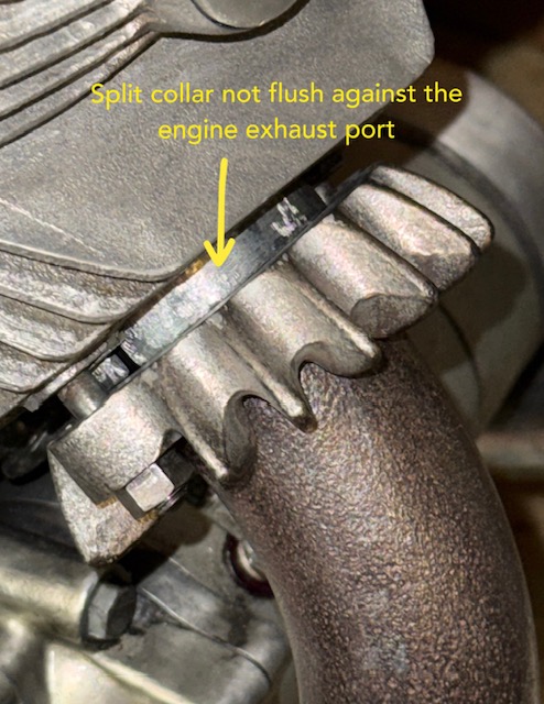

First, when everything is assembled and installed, the “joint” does not directly come into contact with the engine exhaust port (see photo). Instead, it is about a quarter of an inch away. Is this correct? Was this the intended design?

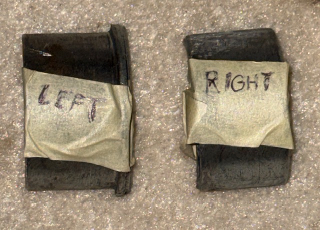

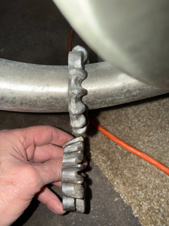

Second, you were right about the exhaust headers being somewhat different. The exhaust headers are different in overall size and as a result, the “joints” on both sides of the bike are different in diameter, thickness and overall size. It therefore follows that the collars on both sides of the bike are also different in size.
The collar-halves with the raised flanges are installed on the left side of the bike. The collar-halves that do not have the stepped flanges are on the right side. Otherwise, they will not fit. This is the case with my 1965 CA 77 Dream. I don’t know about other years.

The joints do not usually tighten right up to the head. What you've shown in the last photo is normal and the intended design.

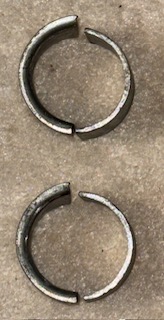

From the photos you have provided, it is now easy to see you have parts from 2 different serial number bikes. Both joints should be the same and all 4 split collars should be the same if all from the same bike. Because of this, it is possible that the headers and mufflers are also different. That may not be a problem is you are not looking for "authentic" and can get both sides to work.
The joint with the larger internal diameter should be fitted with the 2 split collars with the flanges. The joint with the smaller internal diameter should be fitted with the 2 split collars with no flanges.

On reflection and re-examination of your photos, I am concerned about the large internal diameter of the larger joint. The internal diameter looks way too big. Anyway see how you go.

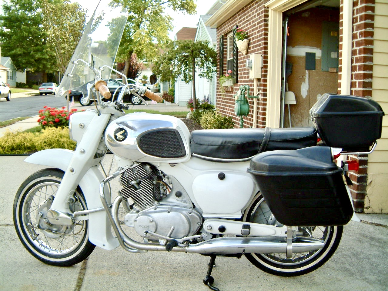

I’ve been restoring this.bike on and off for three years. Attached is a current photo. The only things it needs are new exhaust pipes. Finding originals is next to impossible.
