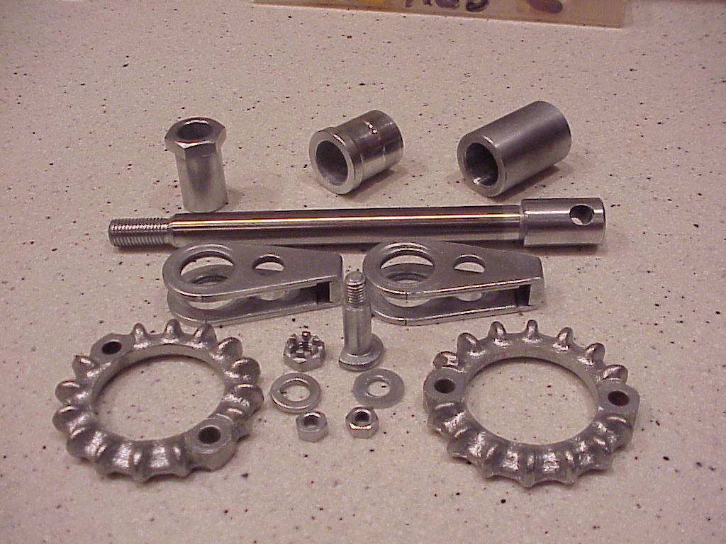

Here is a pic of my completed CL 77 parts. I think they look damn good. I'll be doing more over the long winter which has just started. I'm going to try a test spoke from an old Harley to see how it comes out. I might just end up unlacing my two wheels and stripping and replating all the spokes. That's $240 in new spoke savings based on Honda prices. More if you go stainless from Buchanan's.

Wilf, thanks again for sharing your recipe for zinc plating. I think it is fair to say that anyone involved in bringing old bikes or cars back to life should be aware of this process and set up to replate old parts. I can't wait until next spring when somebody asks if I both NOS parts for the bike and I can smile and say, "No, they're all original.... why??".

Snakeoil............nice touch! I hope my stuff turns out that nice. I will be starting with my spokes. Picked up an Atlas DC/AC train transformer that should work. Looks like I will try your electro solution.
Did you polish those pieces after they came out? I add some more info to the thread by next week.

Very nice work indeed, Rob! I agree 100% with your observations and tips, and I'm sure others will benefit from your detailed posts.

Zoom,
The only polishing was on the axel and it was not polishing but really sanding to remove the plating to bring the axel back to spec in order to fit the ID of the wheel bearings. I did polish it once the zinc was removed. Otherwise, you just have to card, which is scrubbing with a brass brush or even steel wool to remove what I believe is an oxide layer left behind by the plating process. As you brush the surface, the dullness is removed and the bright zinc remains. And this is NOT MY PROCESS, Zoom. Wilf shared this process in another thread and it was referenced in this thread which is where I found it.
