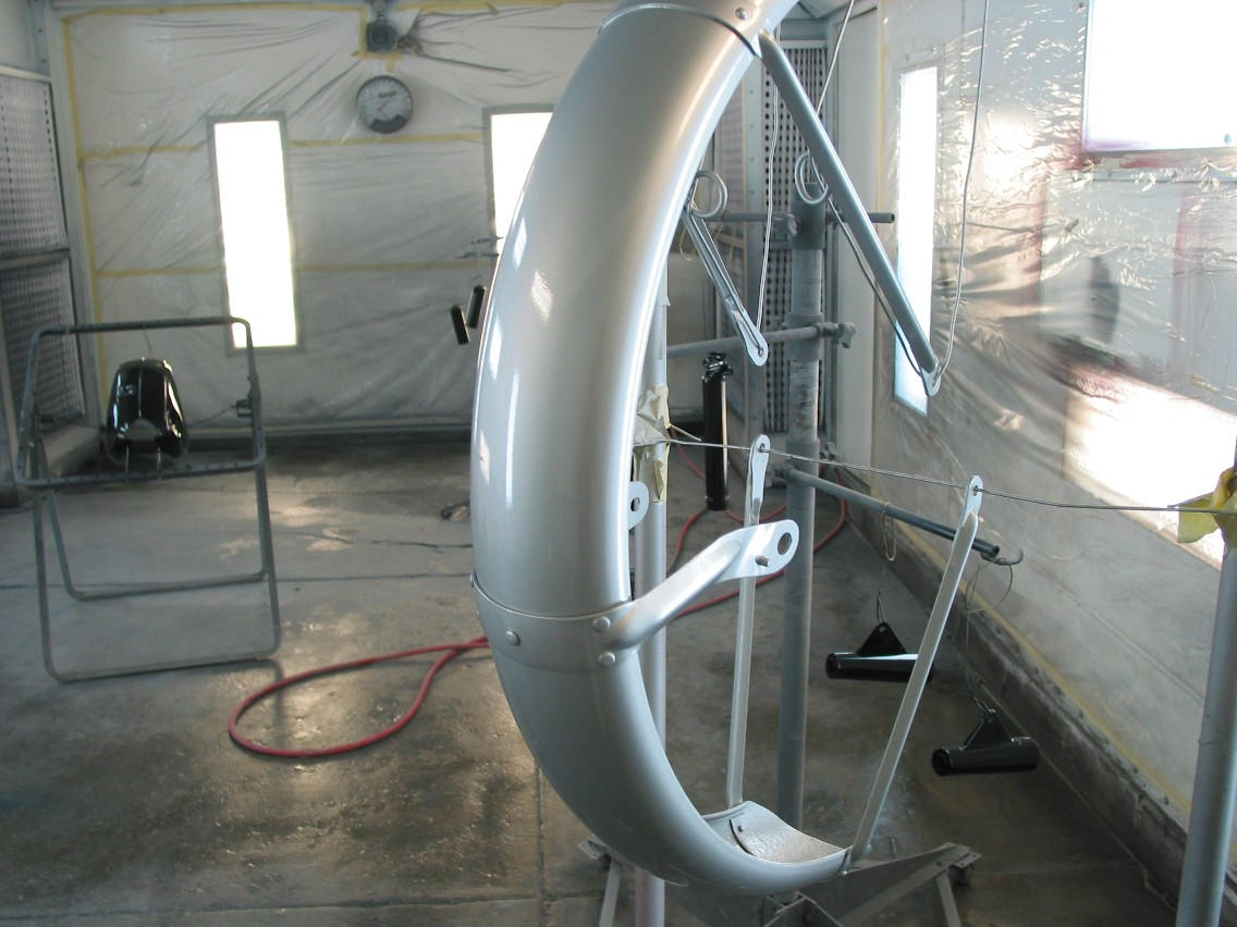

are you rattle canning these pieces or are you using a real paint gun? The results look good in the pictures either way.

i did the undercoat and rattle can outdoors, we did the primer/sealer/color/clear in the booth.
undercoat - it was difficult to get good coverage without over applying...leading to terrible bubbling
rattle can - rustoleum 7716 heat resistant silver
primer - glasurit epoxy primer, a quick sand and scuff after the parts hung around for a few weeks and they were ready for color
sealer - put this on parts (fork cases and footpeg brackets) that missed primer day
black - glasurit 55 series 1250 deep black. painted everything except the frame, swingarm and center stand
silver - glasurit 55 series formula for sunbeam silver metallic C2M MA097.50 (it's listed as a 70's mazda color)

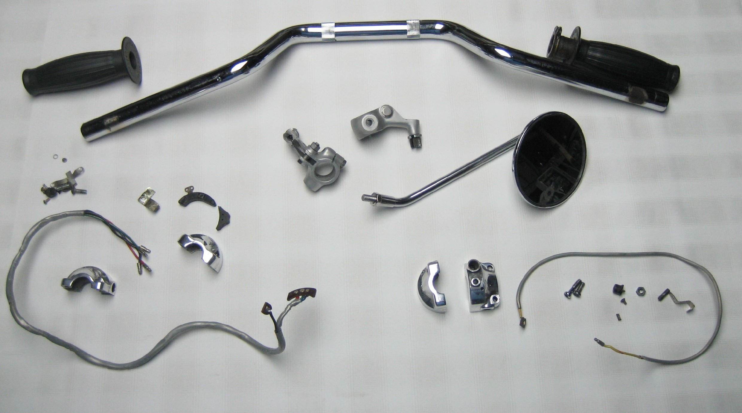

handlebars
Post by mobilyte » Thu Jul 15, 2010 4:25 pm
the mid height bars that were on the bike polished up nicely, but it was missing the dimmer/horn switch assembly. the starter button wasnt working when i picked up the bike and i managed to break the starter button wire. i dont have a single matching pair of levers either...
i think the original dimmer/horn harness is blue, but one of the spares had a gray harness that i preferred. the contact board of the dimmer switch was shaped differently and didnt fit the switch housing, so i swapped and resoldered those.
i checked the order of the red/green/blue wires several times, but i'm not sure if i wired the switch correctly. the forward position is normal and back is bright...?

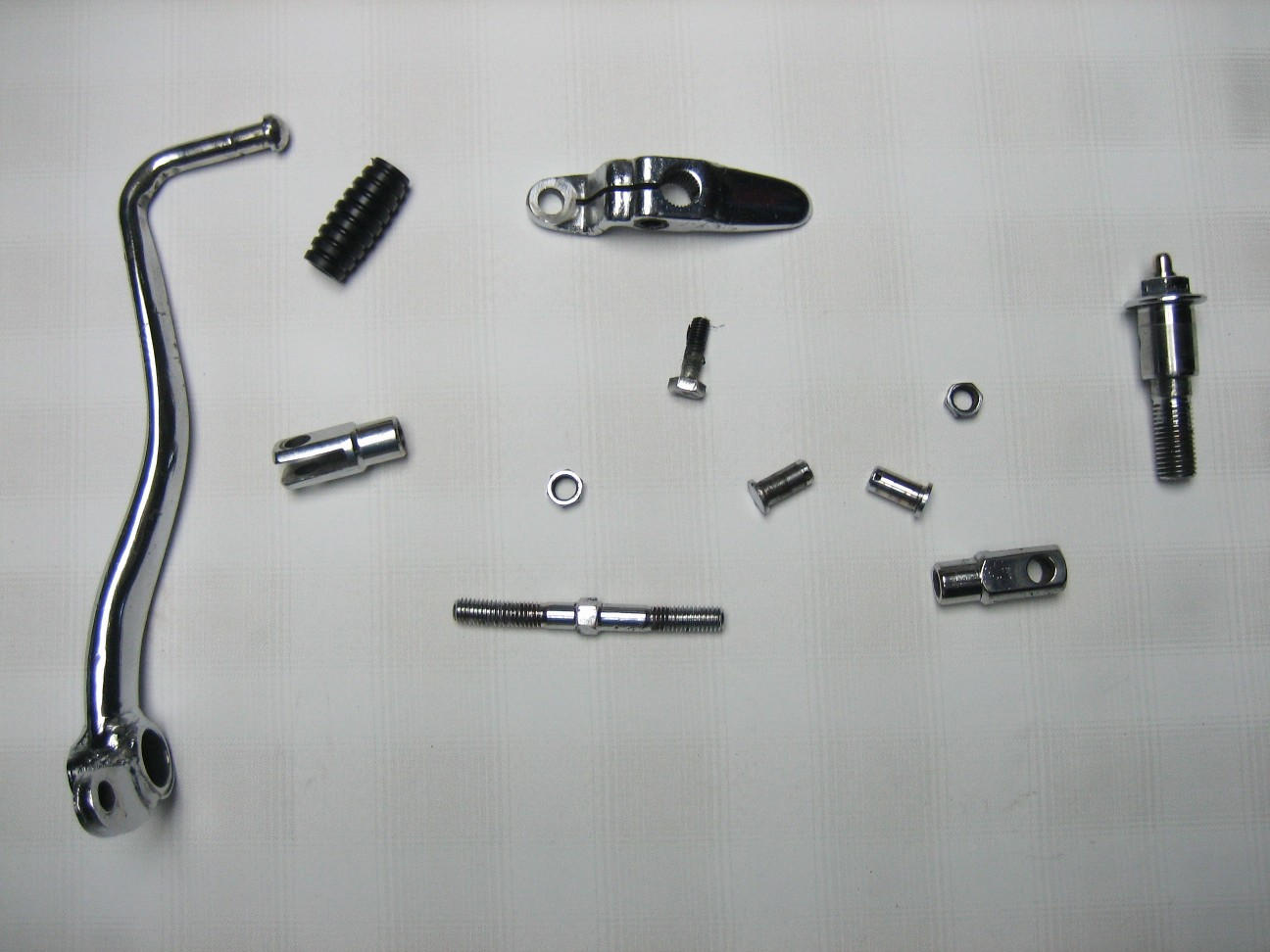

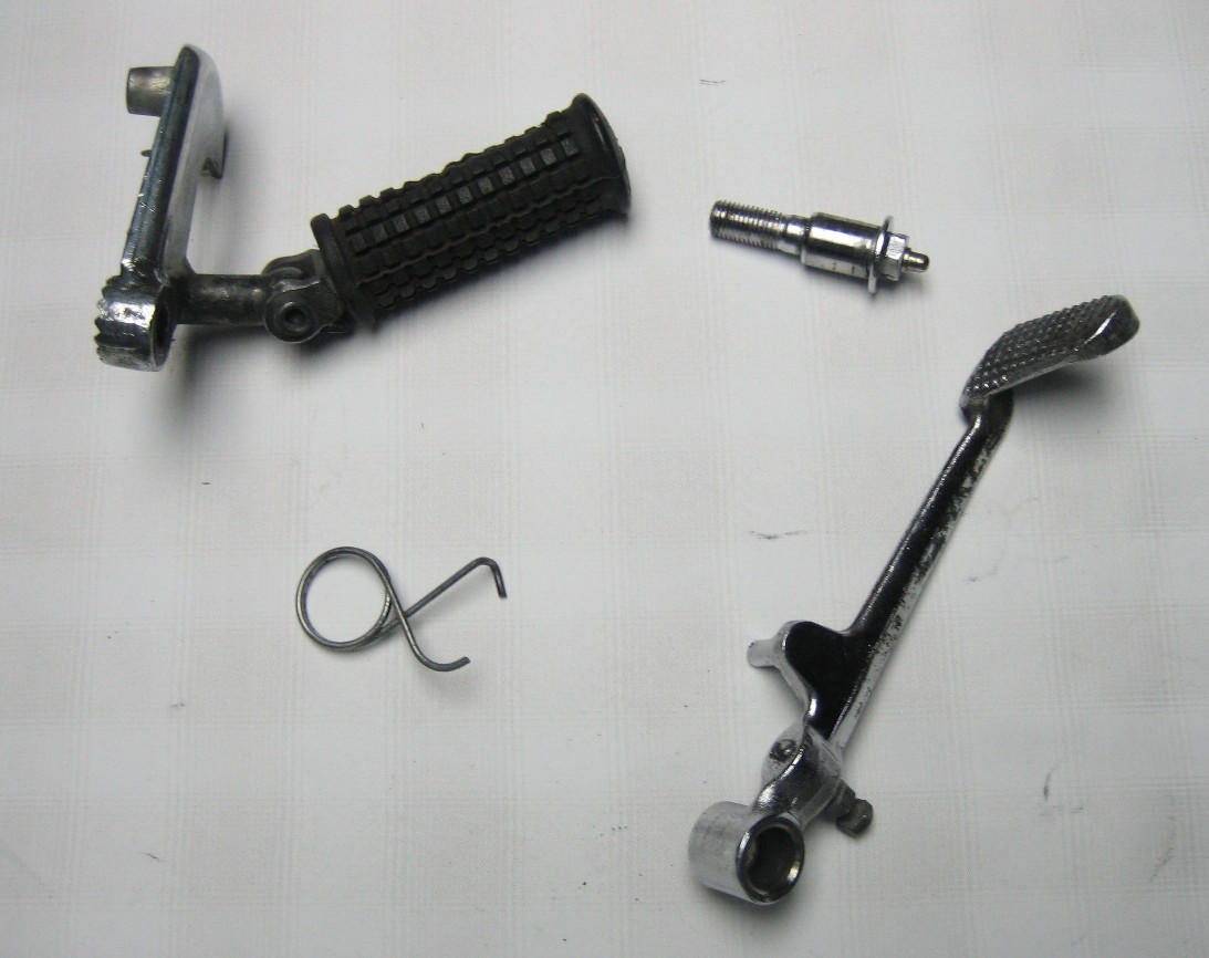

shifter and rear brake
Post by mobilyte » Thu Jul 15, 2010 4:30 pm
cleaned up and polished the shifter and rear brake pedal parts, they'll eventually need to be properly refinished. i've temporarily used paper clips as cotter pins for the shifter linkage.

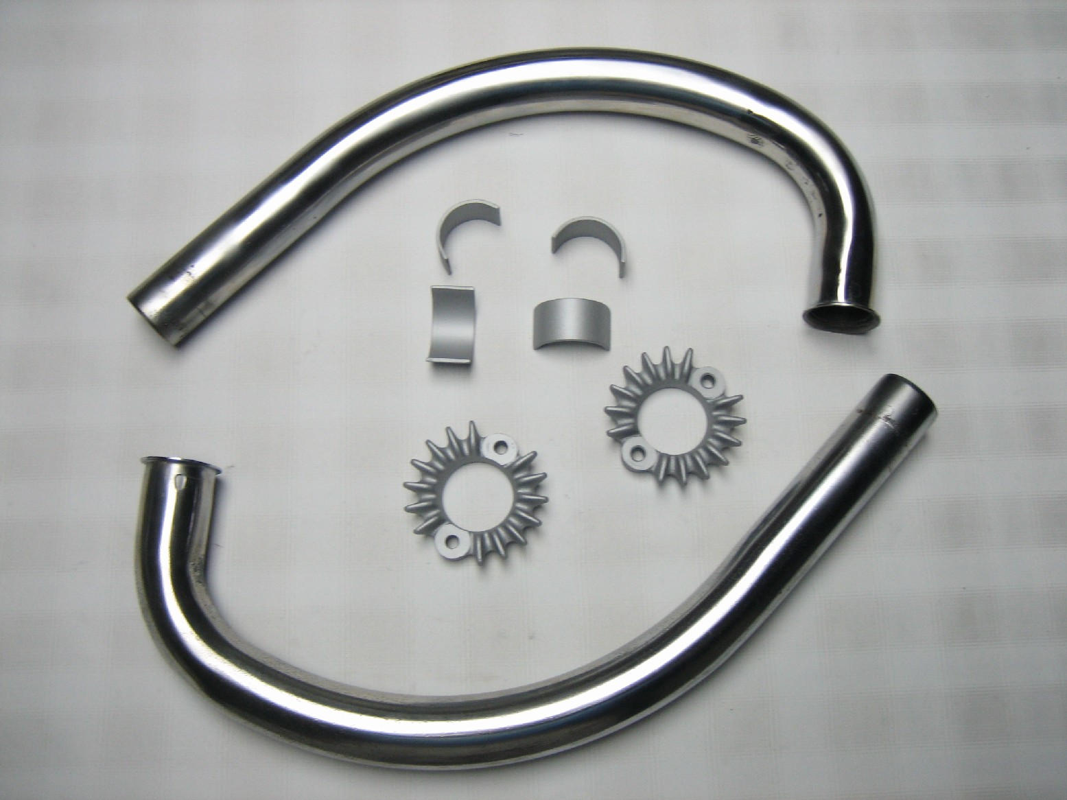

exhaust headers
Post by mobilyte » Thu Jul 15, 2010 4:33 pm
these were the first chrome parts i attempted to clean up, and i made the mistake of bead blasting them before polishing. blasted and rattle can painted the exhaust flanges/spacers.
