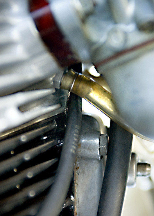

I've done a bit more digging on the function of these tubes, and I think they are used to control a build up of oil/pressure in the crankcase, and they are used as a vent. So, I'm still wondering if these puppies suck in any air, as I checked the inlet portion of the spigot on the filter frames and it's about 1/8" or less. And, if they are supposed to be venting, wouldn't closing the system by looping one tube into another eliminate that needed venting? When they eliminated that in 1967, did they replace it with some other kind of venting? It's not a big deal to feed those tubes into a filter (like a small oil vent filter), but I just want to make sure that it is essential that it be done.
I'm sure that most everyone knows where these tubes end up, but here's a photo of it anyways. The tubes exit the engine here (one on each side at the base of the head at the rear of the engine), and the tubes curve down and then up into the spigot on the air filter frame.
Sorry for all the questions, I'm just trying to understand it all as I'm sure the rest of us are.

Yet another update (plus I found out what the hoses do through Bill Silver and it's really not that big a deal. "There is no real vacuum signal present in these hoses", to quote him.). I found a couple of small crankcase vent filters that I'm going to use at the ends of those two hoses just to satisfy my paranoid self. K&N, Drag Specialties and EMGO (among others) make these kinds of filters, and I think I'd prefer to have more venting than less, so I'll just do this and we should be fine....and believe it or not, I went for a chilly ride on the 24th and I do notice a bit more oomph in terms of power. Plug check turned out nice and tan, so we're good to go....
Thanks for everyone's help!
