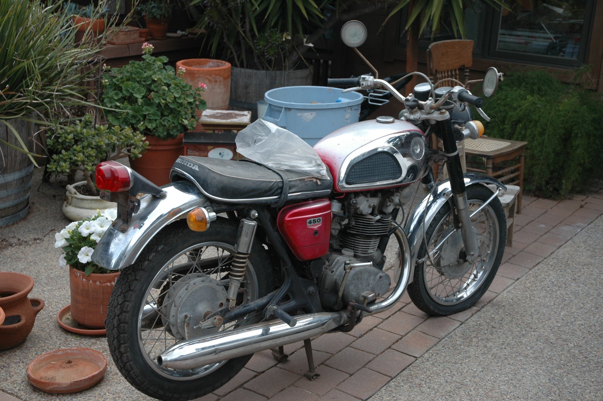

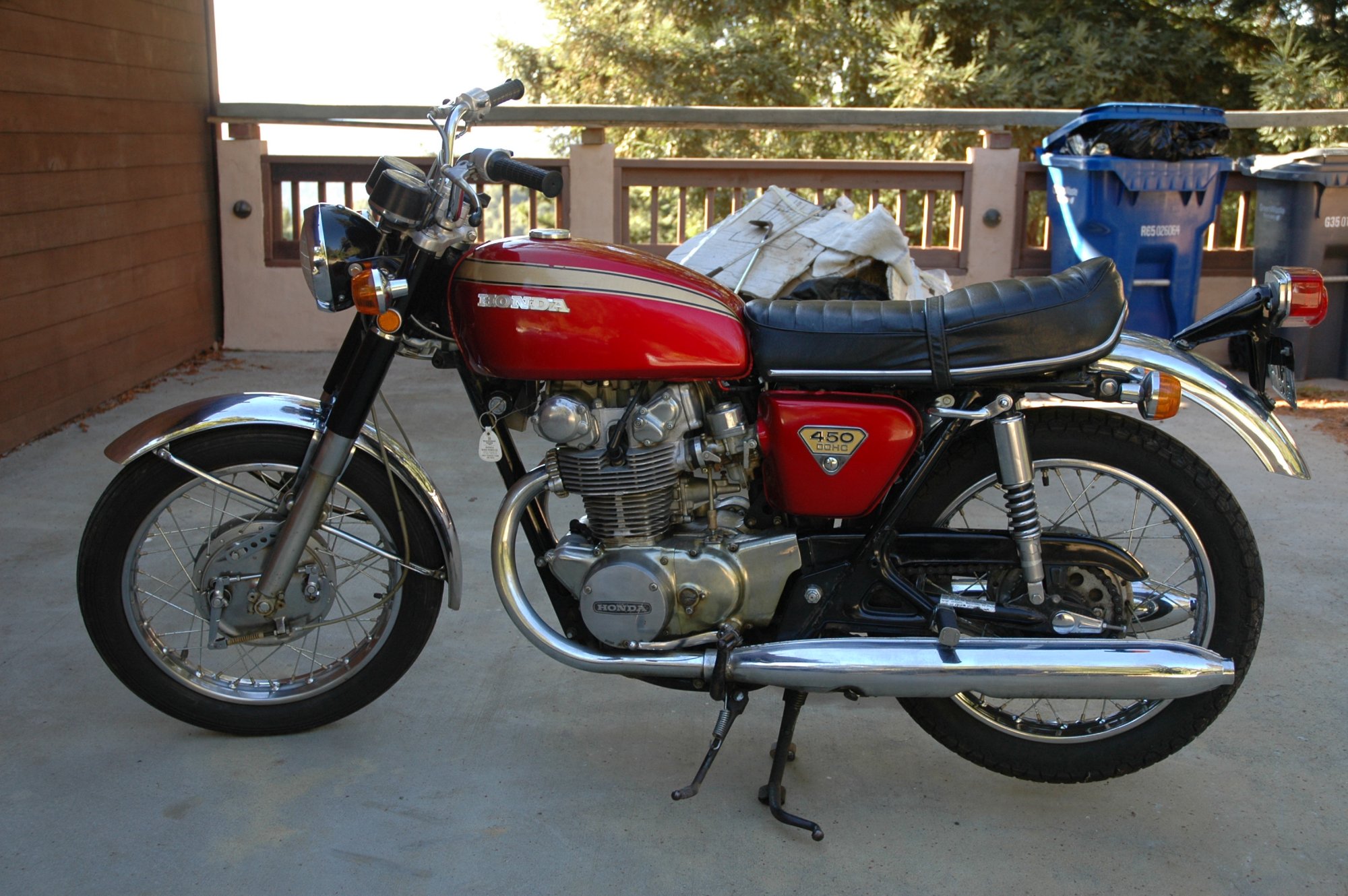

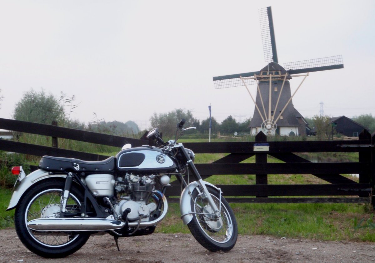

Here some pictures of the 450's :
bomber with windmill.jpg (125.11 KiB) Viewed 3607 times
Cb450 k2 1969 small.jpg (402.13 KiB) Viewed 3607 times
Cb450 k1 1967 small.jpg (443.56 KiB) Viewed 3607 times
