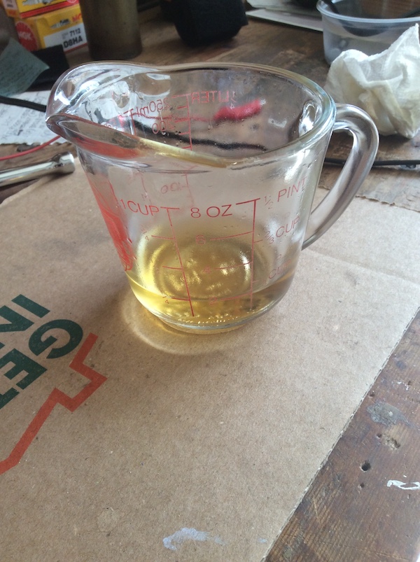

I reinstalled the carb yesterday after the epoxy I put on the loose air filter inlet had cured. All went well. I attached my fuel bottle to the carb this morning and filled the carb bowl to check for leaks. All seemed dry except the bowl drain screw. I must find a new sealing washer for it or try an o-ring. I hesitate to use an o-ring because of the ethanol in the gas and I'm not sure what it will do to it. When I drained the carb after running the engine, the gas had turned from clear to yellowish. I think it's coming from the gas hose I use on my fuel bottle, but I cannot be sure.

Yellowish tint to gasoline

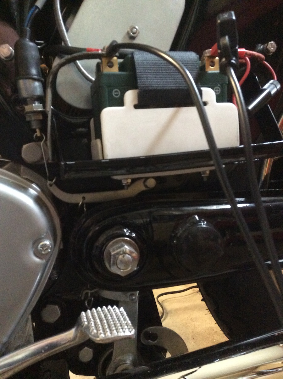

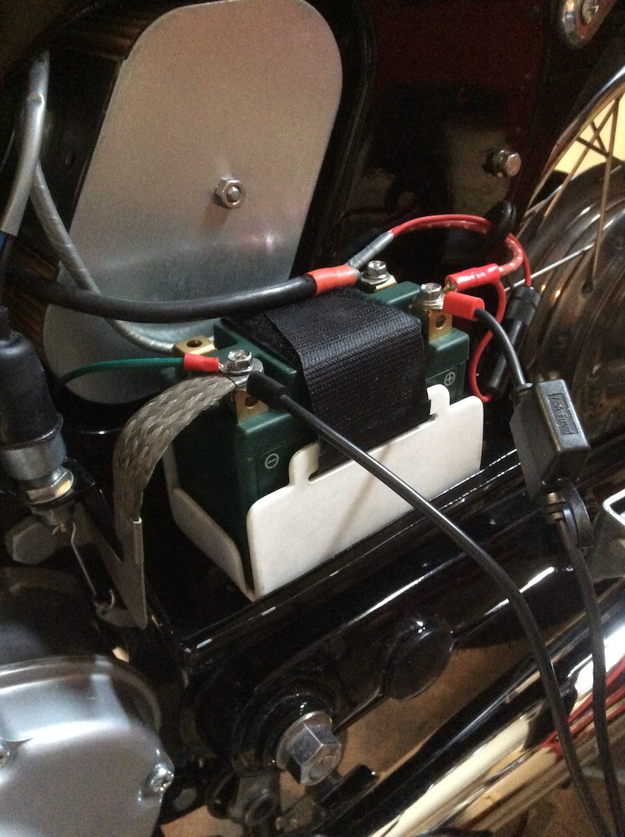

Posts: 1273
Location: Cape Cod, MA
Post by Seadog » Thu Apr 06, 2017 12:23 pm
Finished fabricating a battery box today. I did not modify the stock battery tray at all. I might paint it when the weather is better. Still haven't decided how I'm going to permanently attach the charger wires. I might have to shorten them.
In test fitting the battery side cover, I can see that the latch screw is just too short for easy mounting. I took it off and compared it to the latch screw on the other side cover. It's the same length. I think that one is supposed to be longer than the other. I'll have to check and see if I can find the longer one.
