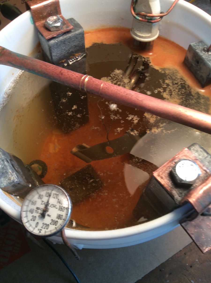

Little happening today. All that was accomplished was to zinc plate the spark plug wire brackets. The bike is still stored at the neighbor's and the driveway is too icy to move it back. Besides, more snow expected on Tuesday, so the snow blower is still needed and taking up the space. The mufflers arrived today. Not as bad as I expected. I'm still on the hunt for OEM or good repros, although it seems less and less likely that I'll find them in good condition. Lots of junk out there.

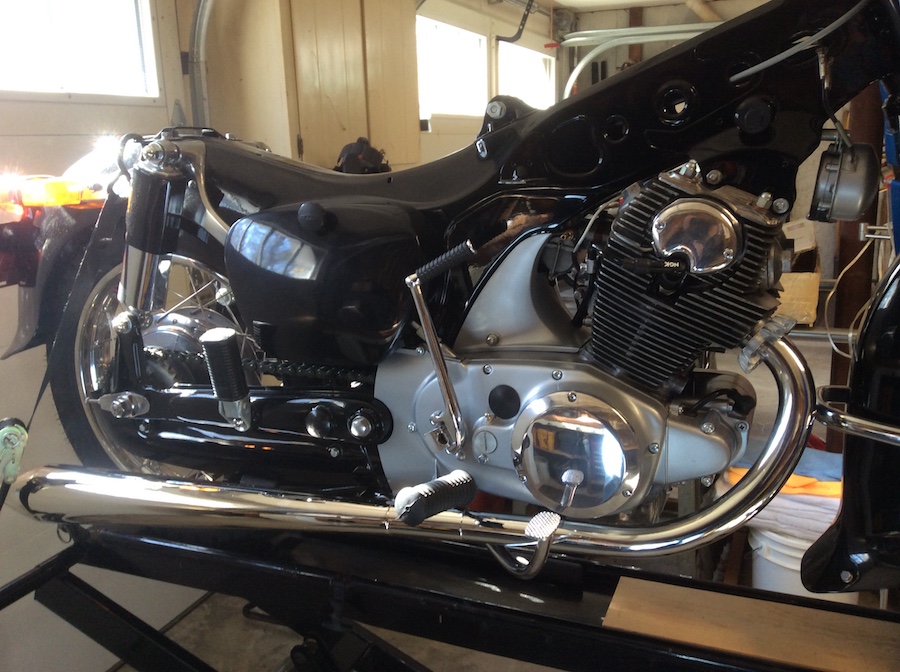

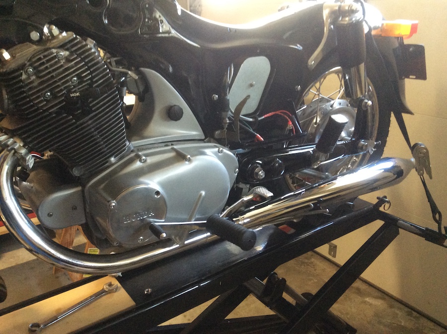

I have considered Overlanders, but I would really prefer OEM. I have a new set of Honda down pipes and the Thai mufflers I've just received will do for now. I actually moved the bike back into the shop this morning and test fit the right side and it all looks ok. I'll probably need some spacer washers behind the mounting tab, but I won't know for sure until I fit the left side. That won't happen until I button up the clutch cover, which won't happen until I can paint it.

Post by Seadog » Wed Mar 15, 2017 12:51 pm
Thanks, I think they're ok. I just temporarily mounted the left side without any real difficulty. I'll need to tweak the fit on both sides as they are not even horizontally or vertically. Some spacer washers should work. I'll also need a rubber bumper for the kickstand, which hits the bottom of the left muffler.

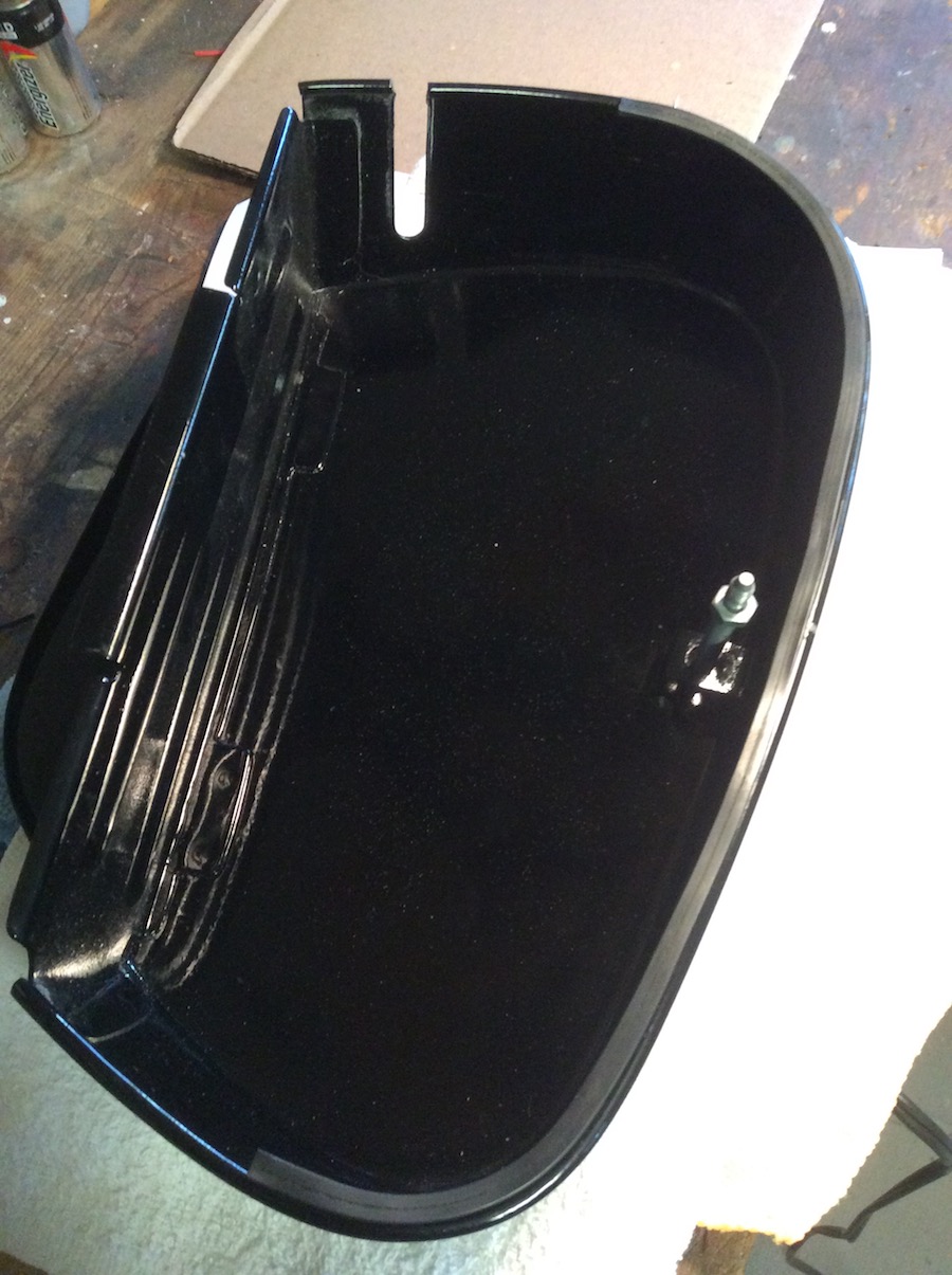

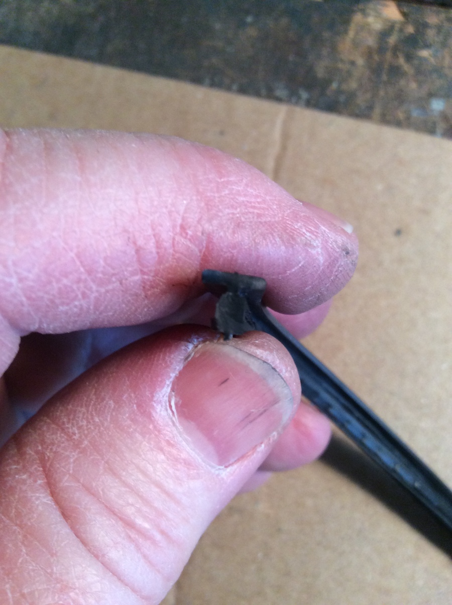

I decided to do something about the missing rubber material along the top edge of the "distribution box" - the right side cover over the coil, rectifier and solenoid. I had removed the dried and broken remnants of that material before painting the cover. I had read somewhere on the forum that some had used a modified windshield wiper blade to form a new gasket/seal. Since I had an old blade, I decided to give it a try. I had to wing it, since I found no other information about how the modification was done. I started to whittle the blade down with an X-Acto knife, but the rubber was just too soft. I ended up using a small pair of surgical scissors to cut off the extra bits. The end product was a T shape. I had to widen the slot in the cover a little bit, using a popsicle stick as a lever. With a little difficulty, I was then able to push the leg of the T into the cover's slot. It helped to stretch the material a bit, then push it back into shape. The final product is just a friction fit, but I don't think it's going anywhere. Pics below.
The gasket seems to be holding well.
Distribution Box Side Cover.jpg (136.89 KiB) Viewed 2822 times
Tough to see, but the wiper blade has been reduced to a T shape.
Distribution Box Gasket.jpg (110.28 KiB) Viewed 2822 times
