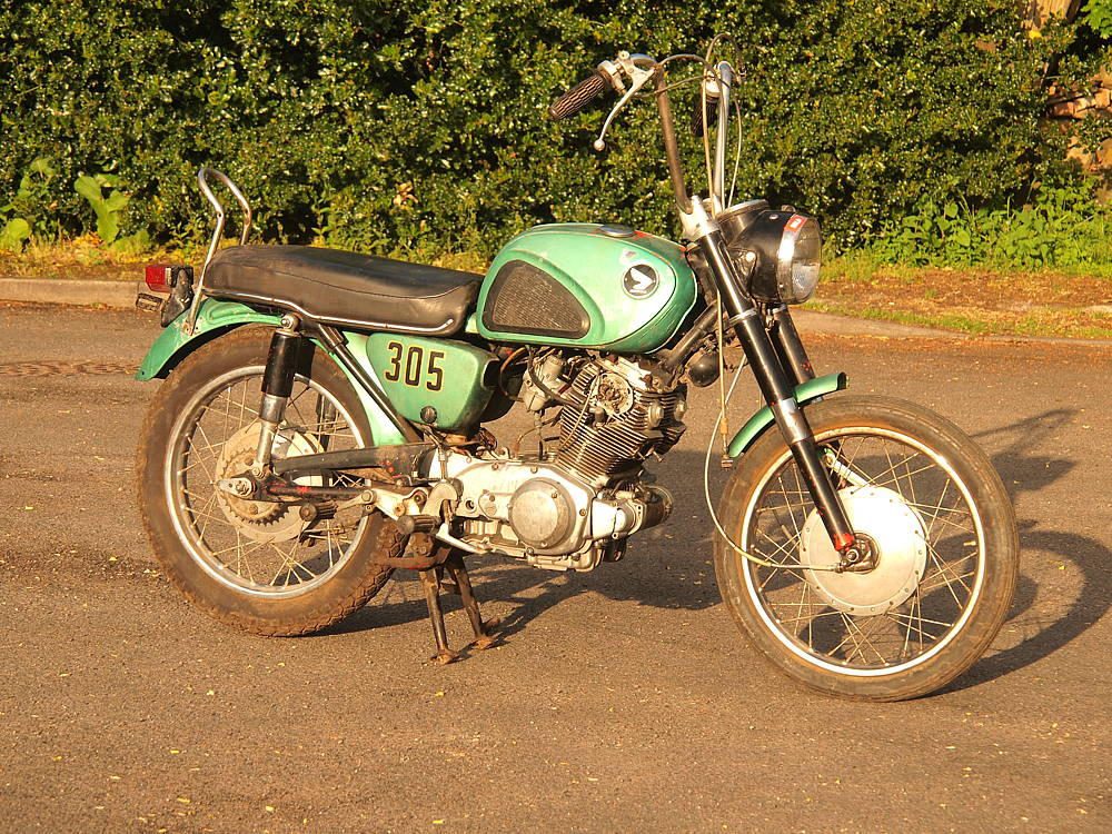

I started down the road today of stripping the bike down in preparation for removing the engine. Oh, boy. Not as in "Oh boy!", but oh, boy, what a mess. I found mismatched hardware, rounded off bolts and nuts, buggered up screw heads, totally rotten wire bundle sheathing, bent footpeg mounts, worn out shift linkage, a big hole in the right side muffler, a bad oil seal on the crankshaft behind the alternator, deteriorated screw caps on the plug wires (where they attach to the coils), and just in general a lot more deterioration and mess than I had suspected. The good part? When I drained the oil from the engine it looked quite clean. That was a pleasant surprise. The engine still turns over, with no funny noises or rough spots in the crank rotation. The carb slides were clean and shiny, even though the venturis on the carbs look dirty.
I'm going to have to chase down a LOT of parts, little stuff. Some hardware, the wire bundle sheaths, most of the cables (clutch, rear brake, tach, speedo, throttle), the footpeg rubber, plug wires, and who knows what else. It's going to be a big job. But, I knew that. I was never any good at sewing, anyway (but I can bake!). Well, I'm committed now!

From what I've read, this means the bike was made in 1965. So, it's really a 1965 model.
Dirty carburetors.
Under the drive side case:
Dirt!
You know, I really thought I had taken better care of the old girl than I apparently really did. I found so much "what was I thinking" stuff on her that I had to stop and shake my head - more than once! It's a little discouraging, the condition she's in, but I suppose far worse has been brought back from the dead. She deserves it, and I promised her and myself I'd get her going again. More than that, I'm going to get her back to like new, and I'm going to ride her.
