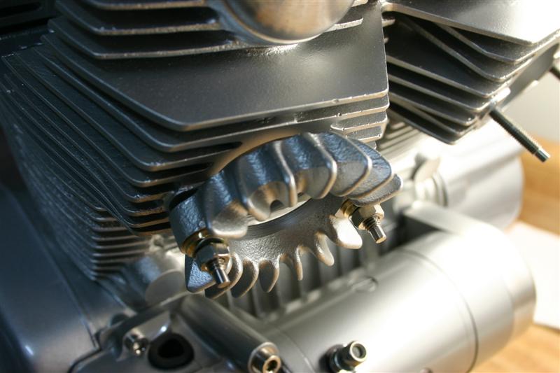

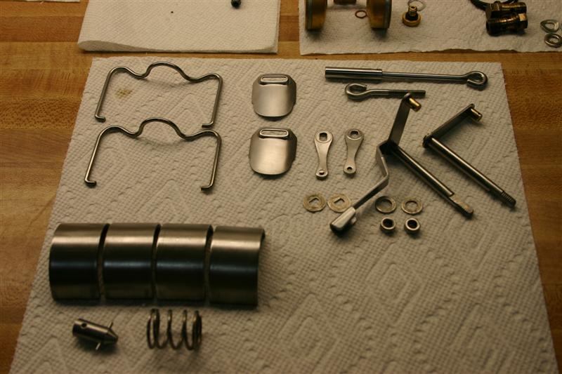

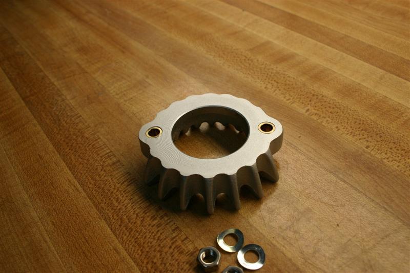

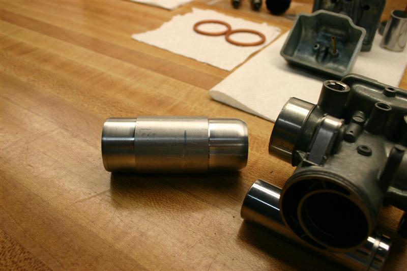

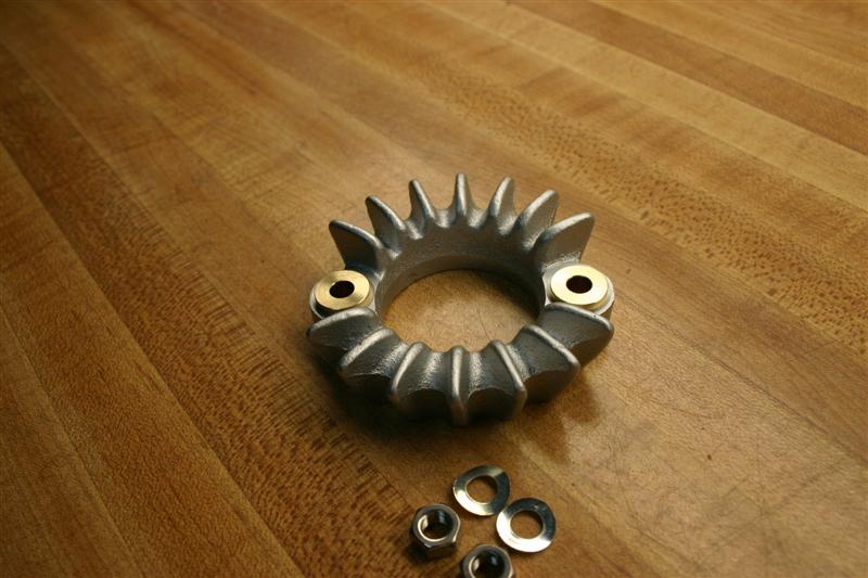

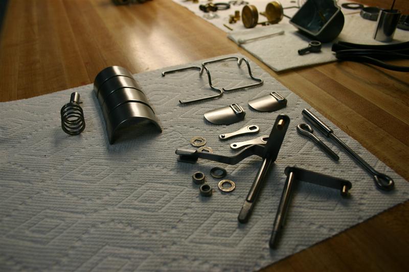

A few more small details finished. I made an arbor to restore roundness to carb inlet - one end of the tool is .007" smaller than the finish end [end w/ the smaller radius on cnrs]; It works well, using plenty of grease. When done, I OD bored the outside diameter for clean-up, may work up some sort of filtered velocity stacks. I also re-worked the exhaust clamps, as the holes in them would clear an 8mm bolt - too sloppy. I figured the spread on the 6mm exhaust studs and bored the holes to accept some bronze bushings I made; also restored the spot face on the clamps so that the bushing head would seat squarely. I painted the clamps with a hi-temp ceramic paint, then baked them in my wife's oven [while she was at work, of course!]. A;so have some carb parts ready for zinc plate - bought a Caswell plating system - this will eliminate numerous trips to platers, and can proceed at my own pace - will have pics of finished results.
engine build 007 (Medium).jpg (70.8 KiB) Viewed 9627 times
engine build 006 (Medium).jpg (63.92 KiB) Viewed 9627 times
engine build 005 (Medium).jpg (55.07 KiB) Viewed 9627 times
engine build 004 (Medium).jpg (58.53 KiB) Viewed 9627 times
engine build 003 (Medium).jpg (61.77 KiB) Viewed 9627 times

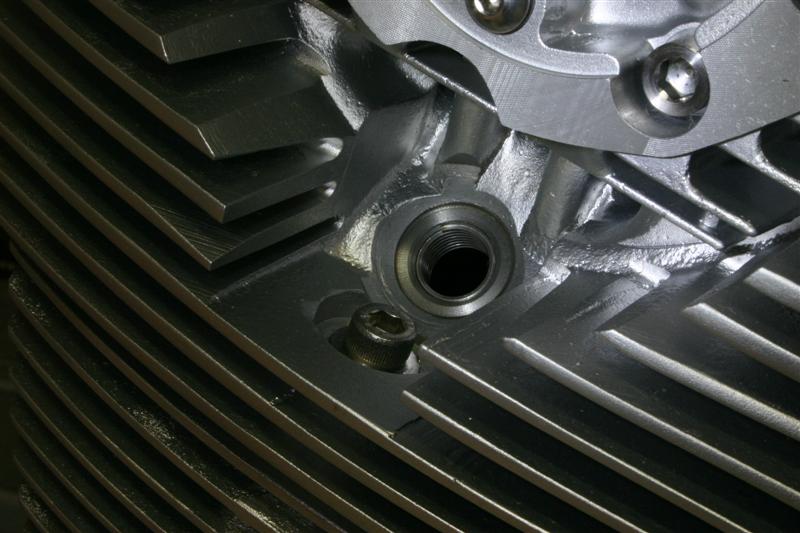

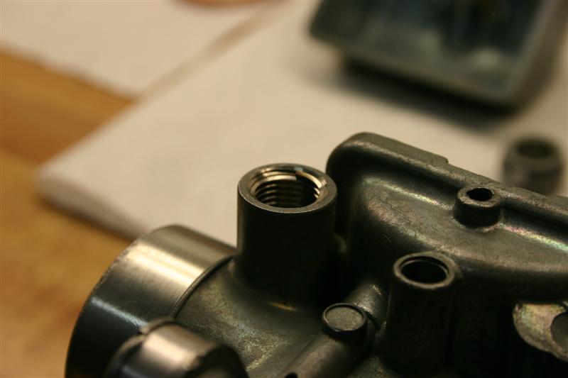

Post by Dick Eastman » Tue Nov 22, 2016 6:50 pm

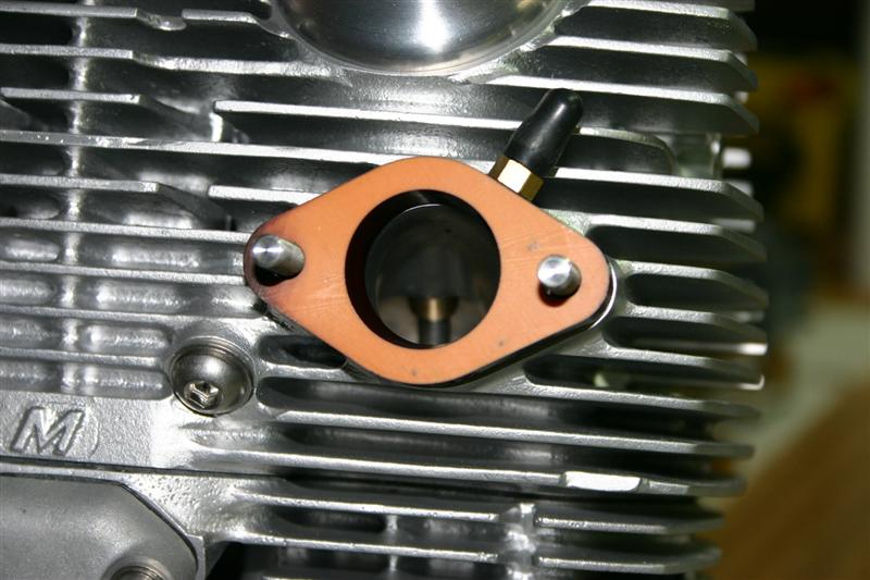

Last couple pics, also shows heli-coil in carb fuel inlet
engine build 002 (Medium).jpg (53.45 KiB) Viewed 9619 times
engine build 001 (Medium).jpg (33.65 KiB) Viewed 9619 times
