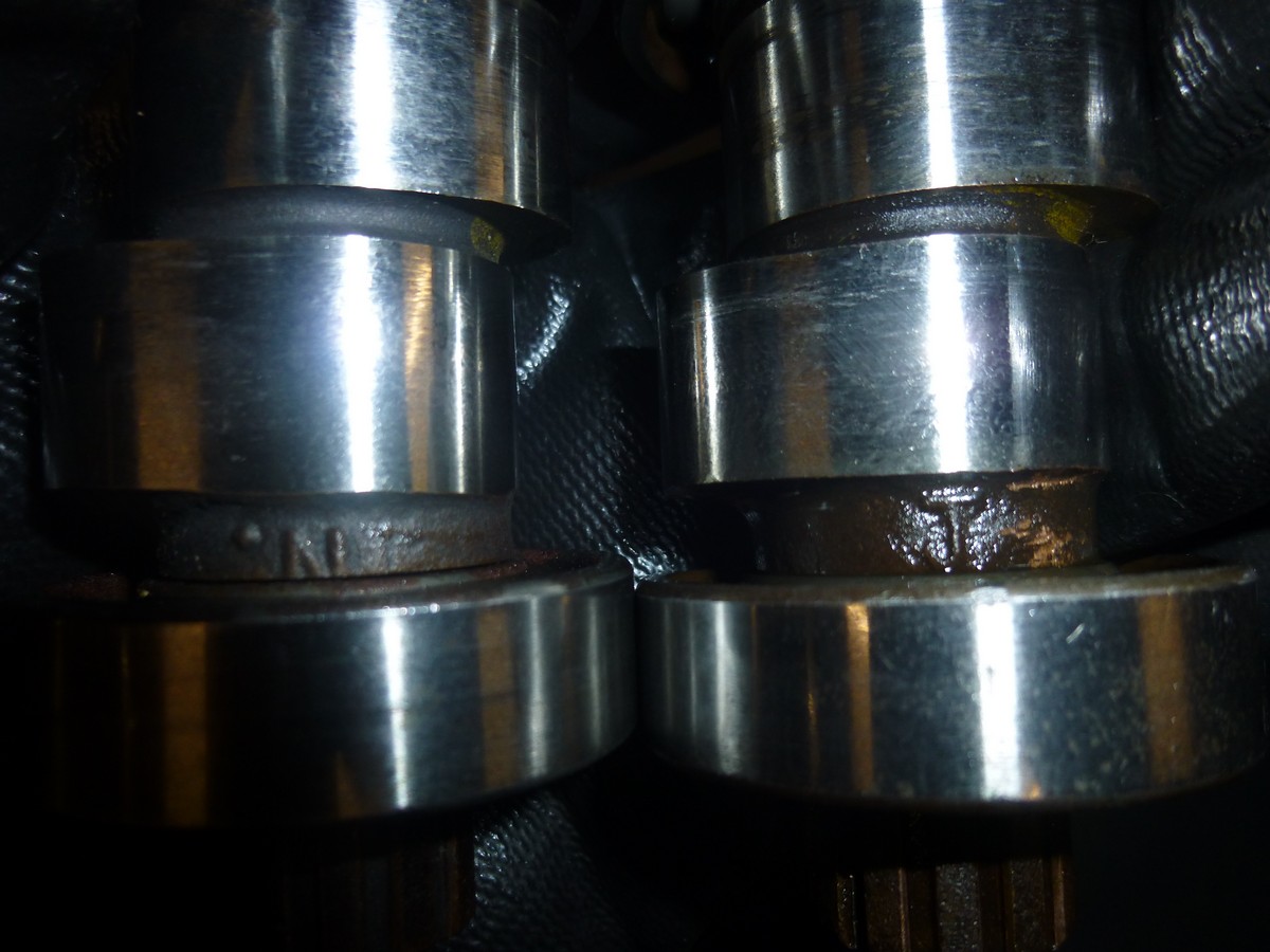

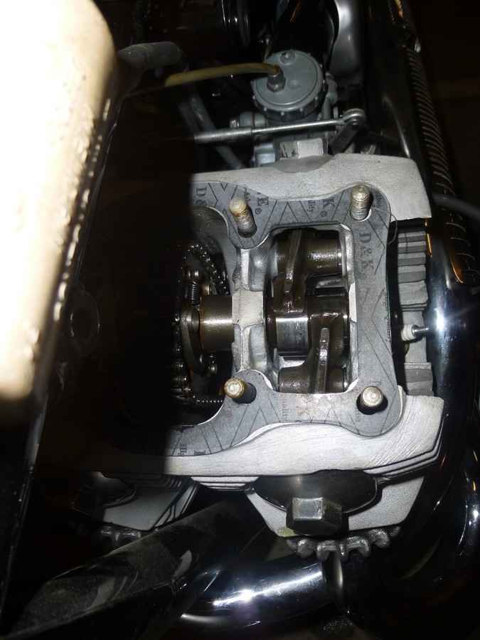

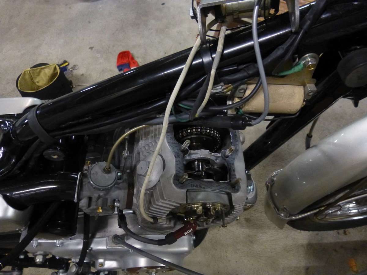

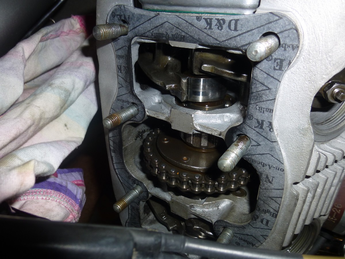

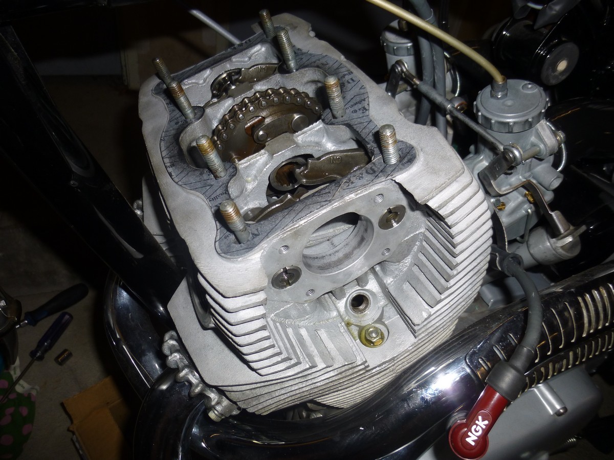

The pistons are probably at the link I attached the other day. The pistons were just one size larger as far as I remember, I bought the complete assembly with the barrels on ebay. I don`t think that would make a difference.

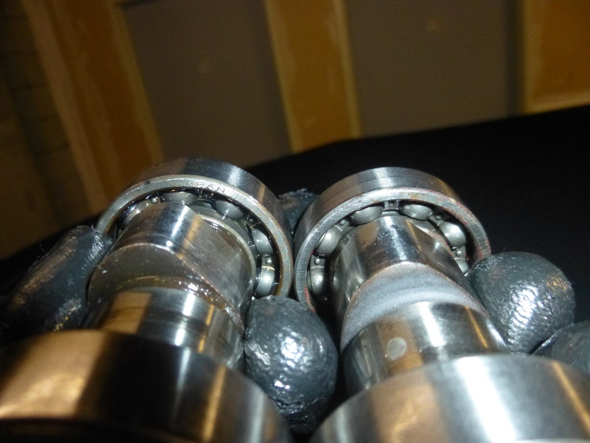

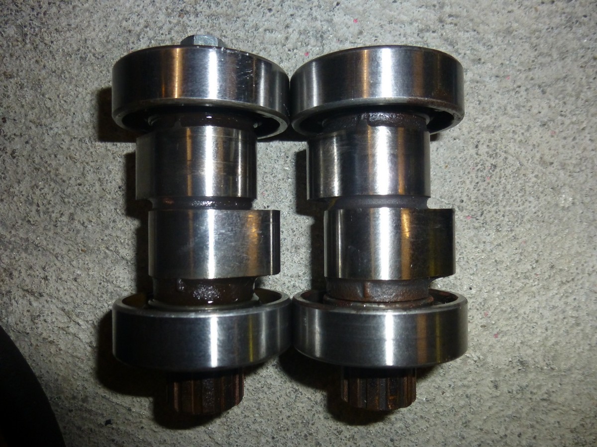

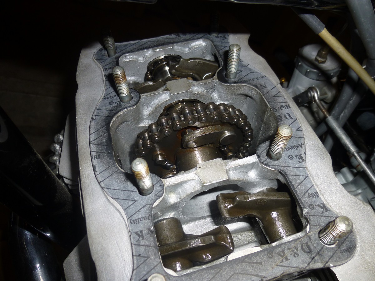

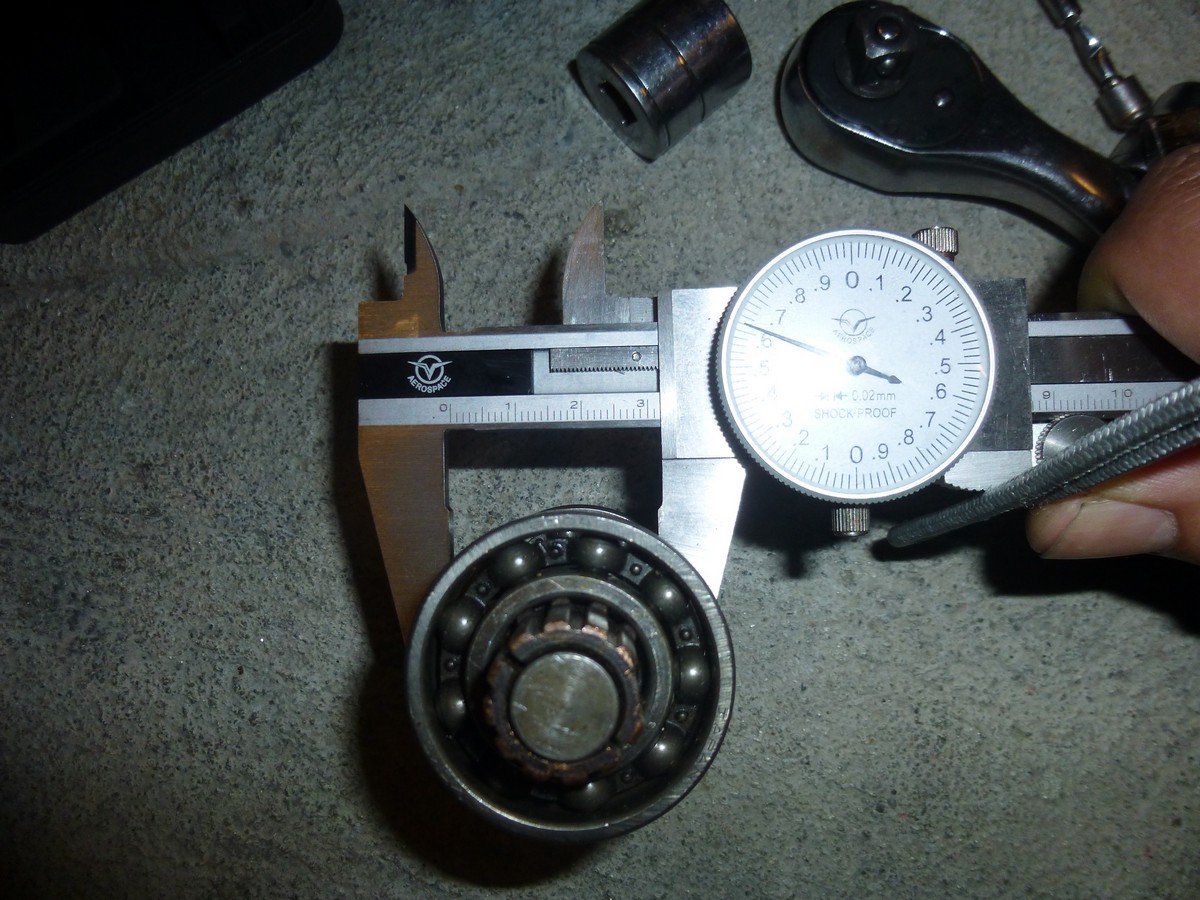

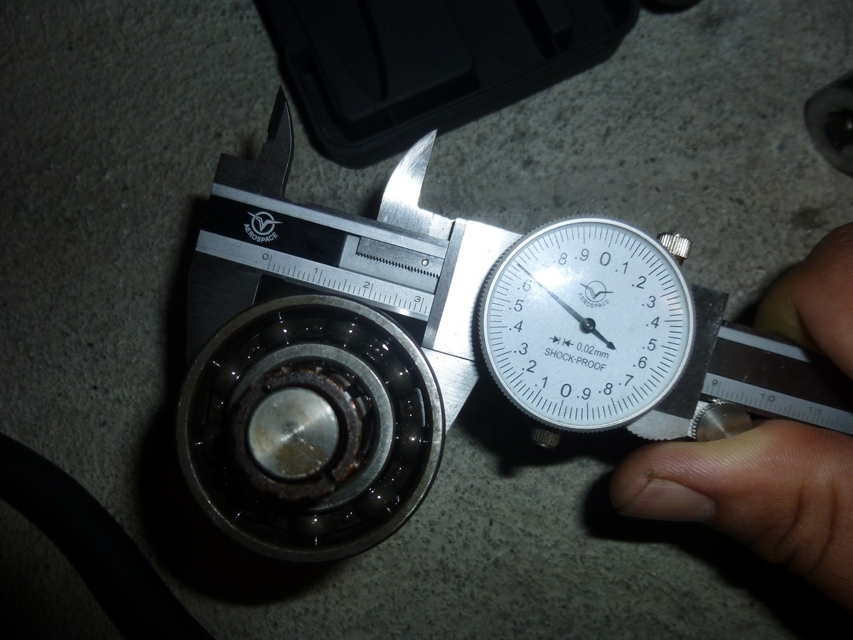

At the weekend I managed to take out one of the cams leving the engine intact and fix the leaking. For some reason the were not in the correct position when I assembled them together for the first time. I compared the left cam to another one that I have in stock and there was no difference. So either these are not race cams or both are. There are some letters on them too (l,m), any idea what these stand for?
Cam1 lobe1 size
Cam1 lobe1 size
cam2 lobe1 size
cam2 lobe1 size
cam2 lobe2 size
cam2 lobe2 size
cam1 lobe2 size
cam1 lobe2 size

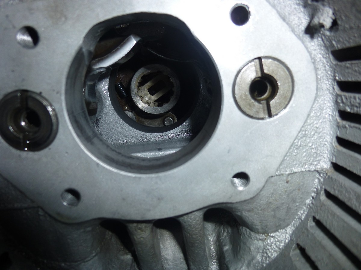

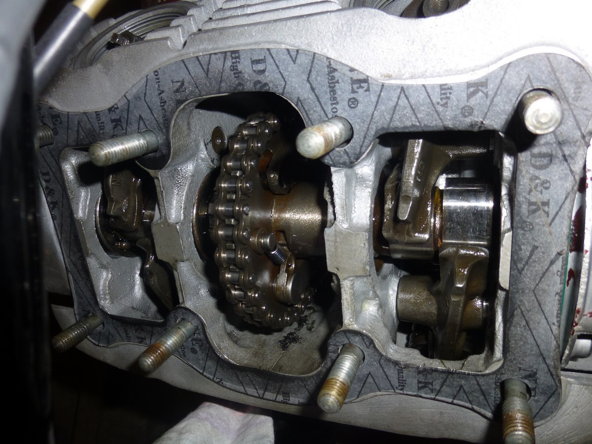

Post by apeonwheels » Wed Nov 11, 2015 10:07 am
New pics

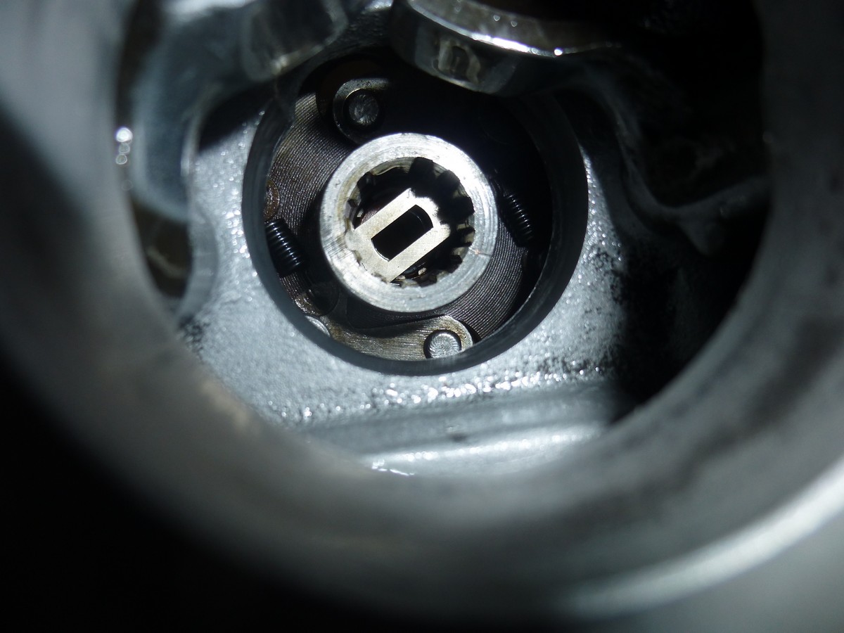

Post by apeonwheels » Wed Nov 11, 2015 10:13 am
Sorry, does not let me upload all at once

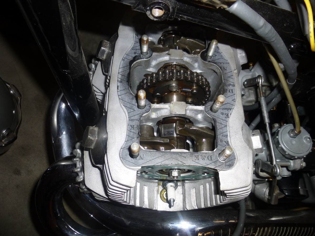

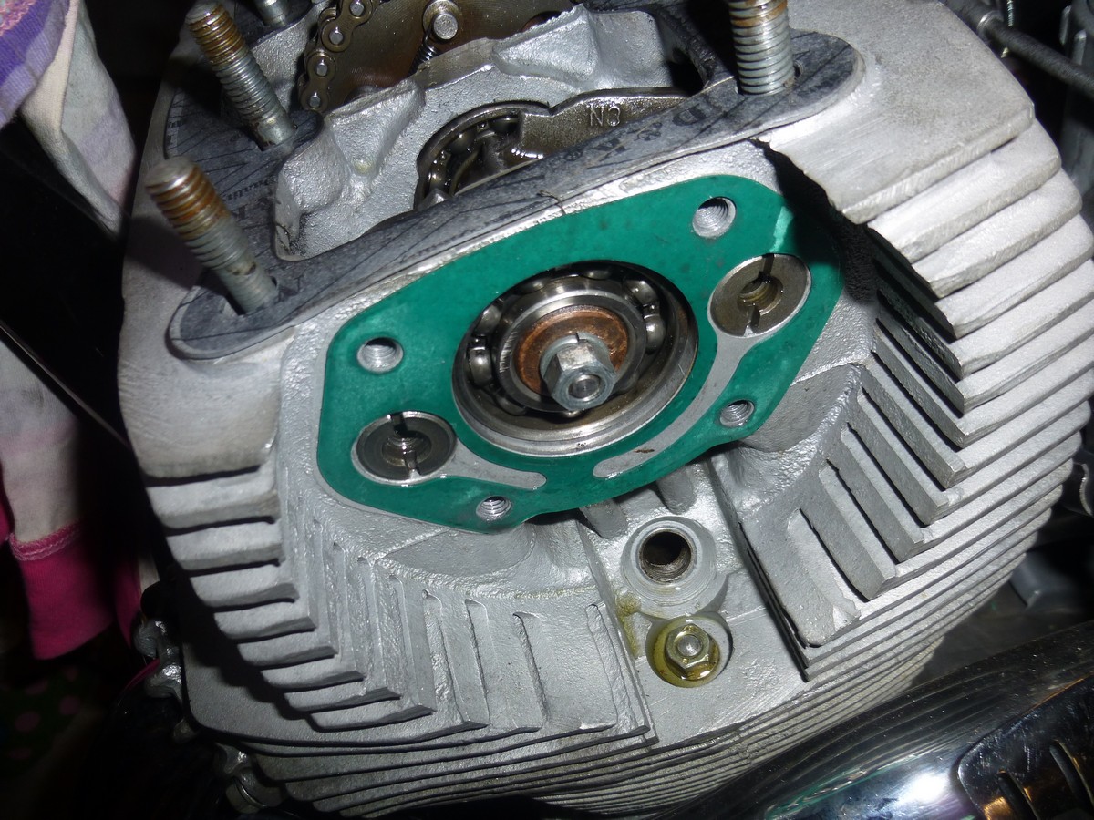

Post by apeonwheels » Wed Nov 11, 2015 10:15 am
Everything seems positioned correctly

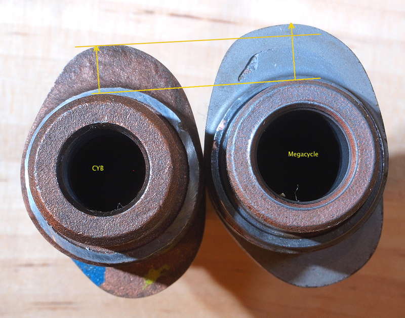

Post by G-Man » Wed Nov 11, 2015 11:12 am
Great pictures but I find it hard to tell. These are both race cams. Left is a Honda CYB cam and right is a Megacycle. You can just see on the Megacycle where it has been welded up on a standard cam 'blank'.
